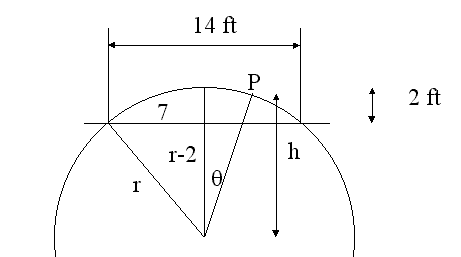

I am an artist, I know a little about math but apparently not enough and I need some help. I am painting a mural on a domed ceiling. The dome is circular, it is 14' in diameter and gradually goes up to 2' high in the center. I need to "cut" this dome into 6 or 8 equal "pie" shapes in order to make a template to transfer my design onto the ceiling. I am stumped as to how to figure the exact shape and size of each of these pieces. Can anyone help me out? Please?

It's a fairly simple bit of geometry to work out the shape assuming the dome really is spherical as you described it. The picture is a section through the centre of the dome.
To find the radius of the dome r, use Pythagoras theorem
r^2 = (r-2)^2 + 7^2
r = 11.25 ft
To find max value of theta:
sin theta = 7/r, theta = 38.5 degrees
At any point P, the "height" of your template is the distance round the circle from the top of the dome
= r.theta (working in radians)
= 2 pi r theta / 360 (working in degrees)
The radius of the horizontal circle round the dome through P is r sin theta
So the "width" of the template at that point is 1/8 of the circumference of the circle = (2 pi r sin theta)/8
Work out the width and length from the top at say 10 different values of theta between 0 and 38.5 degrees and plot them out to make your template.
As a check, the angle between the two curved sides at the top of the template must be 360/8 = 45 degrees. At the bottom the width should by 1/8 of a 14 ft diameter circle = 14 pi /8

Thank you AlephaZero. This is what I was looking for! OOOO's
