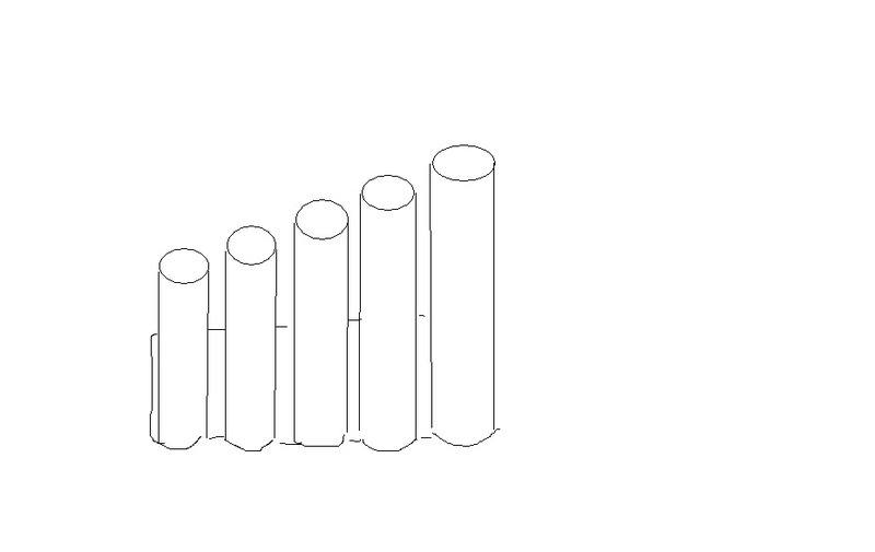

Okay, we need to build an instrument that we can play a song with. The audience needs to recognize the song in order for us to get full points. You can't use any instrument parts and the instrument must be constructed from scratch. I was thinking about making a tubed instrument like this:
Does anyone know what this type of instrument is called?
Now, in order to make this instrument I need to perform some length and mabye some tube diameter calculations right? My teacher gave us all of the note frequencies and we also calculated the speed of sound in the classroom.
Am I suppose to use the equation: [tex]v=f\lambda[/tex] to calculate the wave lengths? I know the length formula for tubes with one end closed: [tex]l = \frac{1}{4}\lambda[/tex] -- for the 1st harmonic
The thing is I don't know what formulas I need to use to compute the length of the tubes. Do you divide the speed of sound (343m/s) by the note frequencies and then multiply the resulting wavelength in this equation: [tex]l = \frac{2n-1}{4}\lambda[/tex]?? How do you know what nth term to use? For example, for the note C, it has a frequency of 512 Hz. So can someone please show me an example of how I can calculate the length of a tube with one end closed that will produce that note?? Do I need to take the tube's diameter or anything into mind? I just don't get how fundamental/nth harmonics are related to notes and which ones goes with which. Thanks!

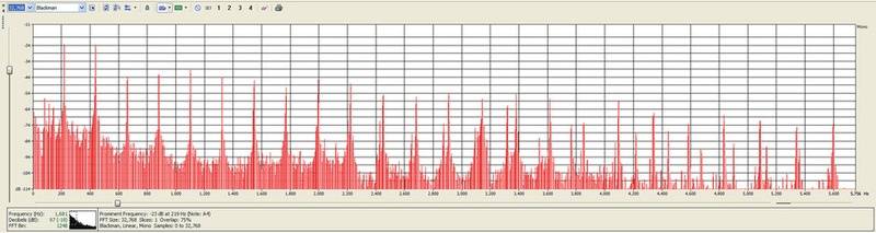

When you play a note on a piano, say the 440 Hz "A" note, that 440 Hz frequency is the fundamental frequency or first harmonic of the note. That means that it is the loudest and most recognizable frequency present in the frequency spectrum of the sound of that note. However, there are also other frequencies present--there is the 880 Hz second harmonic, 1320 Hz third harmonic, 1760 Hz fourth harmonic, etc. present in the full soundwave. The certain combination and amplitude of the various harmonics that make up the soundwave give different instruments their characteristic timbres--it is largely because of these harmonic differences that you can distinguish the sound of a flute from that of a violin or a clarinet.
http://en.wikipedia.org/wiki/Harmonic
Here's an example of a spectrograph analysis for a piano note. The horizontal axis is frequency, the vertical axis is amplitude. Notice how the first harmonic is the loudest and the harmonics occur at regular intervals along the frequency axis.

i think those are pan pipes, south american instrument, very mellow overtones, in other words the even harmonics are predominant.
So am I suppose to find the fundamental frequency: [tex]l=1(\frac{1}{4} \lambda)[/tex] for each note given the frequency of each one?
Solve for [tex]\lambda[/tex] you would get:
[tex]\lambda= 4l[/tex]
Substituting [tex]\lambda[/tex] in the equation [tex]v=f* \lambda[/tex] you would get: [tex]v=f*(4l)[/tex] which is equal to: [tex]l= \frac{v}{f(4)}[/tex]
So, would the length of each tube for every note depend on the equation:
[tex]v[/tex] is the speed of sound ~343.9 m/s correct? [tex]f[/tex] would be the frequency of each note? [tex]l[/tex] would be the length of the tube?
I don't get what each of the harmonics are for, can I just use one of the harmonics to get every note. Make the independent variable just the frequency and solve for the length with the equation above? Will that give me every note accurately or what?
