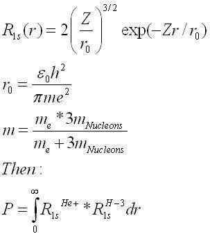

The radial wave functions i have given, you need to add r^2 when you do the integration to find the electron in a certain state. But science the question was "the probability that the He-ion is in its ground state", we should take the projection of the tritium (H-3) wave function (1s) projected on the He-ion (1s) then integrate. Try :) I'll se if i get the right answer.

We wonder how much of the original wave funtion is in the radial wave function of the helium ion.. ? How much they overlap sort of speaking.

I got the right answer, use the wave functions i posted, then SQUARE the result ( iforgot to write that). Then you neglect the reduced mass thing..
The probaility is always the square of the projection. Se pages 72 to 74 in phillps: (4.51) + (4.55)

Well, not in this case, you must find out how much of your wave funtion that is covering the state your are searching for. You can think of this as when you are projecting an eigenfunction to your wave function(that perhaps consists of a superposition of many eigenfunctions/states), to find out what the probability is to get a certain eigenvalue. This thing is similar.

No they are not in the book of phillps, but the problem 9.14 gives you a hint how to get them. you "just add" a Z here and there.. :P
