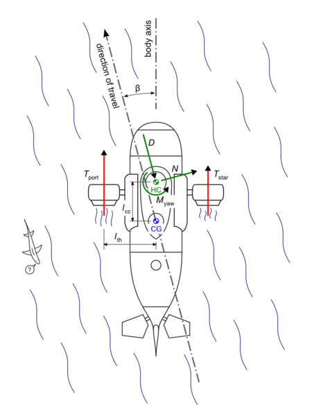

Cautionary note: I'm an airplane-person, not a boat-person, so I'm discussing using airplane analogies. If someone therefore detects stupidities in my writing, I hearby license him to laugh and scold in public.
Regarding drag vs. velocity, I believe OP to be right when taking quadratic instead of linear dependency. From the point of interest here (incompressible viscous flow around a body), the fluid is represented by its Reynolds number. If a 10m long submersible travels at 5kts in 0°C water, the length-referent Reynolds number is about 15 million. That's quite in the range of aerodynamic applications, where it's square of velocity all the way.
Now on to the simulation.
e-dard said:
It may be worth pointing out that i am only interesting in the movement in the x,y plane and that the simulation will not include effects like currents etc.
That's what I concluded from your original post, and drawn the sketch above to that setup. It will also cover the question of "what forces the reduction of rotational velocity" when the power is cut.
Given that you feel more at home with the velocity/heading and angular velocity variables, I'll use them too. But have in mind that x, y and angular velocity arrangement, that lpfr wrote equations for, are equivalent to your formulation. There is no external/internal frame distinction between them, both are external.
There is some difficulty with your setup of angular velocity though. Using the angular velocity around the ICR means that you track not the submersible itself, but precisely the ICR. This is unnecessary and will cause trouble when it comes to what kills the rotation when thrusters are off.
Instead (take a look at the sketch), let's track the CG (center of gravity) of the submersible. Then, you have the velocity of the CG, the heading, and the angular velocity around the CG. Furthermore, note (and this is critical) that the symmetry axis of the submersible does not, in general, coincide with the velocity vector (i.e. direction of motion of the CG). The angle between these two directions is [tex]\beta[/tex].
The red forces on the sketch are powerplant: port and starboard thruster given by [tex]T_{port}[/tex] and [tex]T_{star}[/tex]. Green are components of the response force of the environment: [tex]D[/tex] is drag component of the force (oposite to direction of motion), [tex]N[/tex] is component normal to the direction of motion; [tex]M_{yaw}[/tex] is a momentum that appears due to reducing the response force to a certain point, the HC on the picture (sth like "hydrodynamic center", but the name doesn't matter).
At this point, you may wonder why there are two points considered, both the CG and the HC? Well, thruth is that this is pretty arbitrary looking only at the present problem, there may very well be only the CG. But, in reality, whatever method you would use to determine the environment response components, would require fixing some point for the moment component, and this point would not have anything to do with the CG, only with the shape of the body. Hence, it's given in the image, with an arbitrary distance [tex]l_{cc}[/tex] to the CG (so you can put it to zero later if necessary).
Now, if [tex]v[/tex] is absolute translational velocity of the CG and [tex]\omega[/tex] is the angular velocity around the CG (z-axis), then the equations of the motion are:
[tex]m \dot{v} = (T_{port} + T_{star}) \cos\beta - D[/tex] [1] (in direction of travel),
[tex]m \frac{v^2}{R} = (T_{port} + T_{star}) \sin\beta + N[/tex] [2] (normal to direction of travel),
[tex]I \dot{\omega} = (T_{star} - T_{port}) l_{th} \cos\beta + M_{yaw} - N l_{cc} \cos\beta[/tex] [3] (angular motion around the CG),
where [tex]m[/tex] is submersible mass, and [tex]I[/tex] is submersible moment of inertia around z-axis in the CG; [tex]R[/tex] is the distance from CG to ICR. Of course, [tex]\omega = \dot{\beta}[/tex].
You can model all the environment response components similarly to that of drag:
[tex]D = q (K_{D_0} + K_D \beta)[/tex],
[tex]N = q {K_N \beta[/tex],
[tex]M_{yaw} = q K_M \beta[/tex],
where [tex]q = \frac{1}{2} \rho v^2[/tex], and coefficients [tex]K_*[/tex], are, well, something. The dependency on [tex]\beta[/tex] is somewhat logical: obviously, when [tex]\beta = 0[/tex], in head-on motion whith the least frontal area faced to the flow, the drag will be minimal ([tex]q K_{D_0}[/tex]) and there will be neither moment nor normal force due to symmetry of submersible.
Note the physical dimensions of coefficients: [tex]K_D[/tex] and [tex]K_N[/tex] are length squared, [tex]K_M[/tex] is length cubed. That's because I didn't want to split some stuff out of them, because I don't know how; you'd need a referent area for [tex]K_D[/tex] and [tex]K_N[/tex], and additionally a referent length for [tex]K_M[/tex]. This is actually needed only when you have some external data about non-dimensional coefficents, but not if you are just going to toy with them by hand.
Finally, (denoting heading with [tex]\theta[/tex]) your Euler integretion formulas are:
[tex]x_{k+1} = x_k + v_k \Delta t \cos\theta_k[/tex],
[tex]y_{k+1} = y_k + v_k \Delta t \sin\theta_k[/tex],
[tex]\theta_{k+1} = \theta_{k} + R \Delta t[/tex],
[tex]v_{k+1} = v_k + \dot{v} \Delta t[/tex],
[tex]\beta_{k+1} = \beta_k + \omega_k \Delta t[/tex],
[tex]\omega_{k+1} = \omega_k + \dot{\omega} \Delta t[/tex].
There is a problem though. I have no idea of what the [tex]K_*[/tex] coefficients should be, as well as no idea of value of [tex]l_{cc}[/tex]. These are physically critical: a vehicle moving through fluid may be unstable in some combinations of these, that is have a tendency to "reverse its ends". Equation [3] is what should kill the turn rate when the power is off: when [tex]T_*[/tex] terms are out, it becomes a free oscillatory equation, which should subside the turning motion in a stable vehicle. But it doesn't have to (*) :) In your Euler integration, this would manifest itself by the [tex]\beta[/tex] angle diverging.
(*) In fact, at least there are airplanes which are made unstable like this on purpose, so that thay need a constant power input (handled by the computer) in order not to go awol. If the computer control should fail, the pilot can only eject.
edit:
The above equation for heading update is wrong. It holds that [tex]R \dot{\theta} = v[/tex], hence:
[tex]\theta_{k+1} = \theta_{k} + \frac{v}{R} \Delta t[/tex]
Chusslove Illich (Часлав Илић)

ok, well i guess the first thing i don't understand is why the vehicle's translational velocity would not be in the same direction as the two velocities produced by the thrusters? They are fixed in position and are parallel.
First, I don't quite get what you mean by "velocities produced by thrusters": the thrusters, or more precisely, some given point on each thruster, will indeed have different velocities due to being part of rigid body undergoing rotational motion. The thrusters themselves do not produce these velocities directly, but are being part of forces acting on the body as whole.
Now, imagine first a spacecraft , sailing through vacuum instead of fluid, but otherwise alike our submersible. It is accelerating in a straight line, with both thrusters firing with some force. At one point, one thruster reduces it force by [tex]\Delta T[/tex], and the other increases by the same [tex]\Delta T[/tex]. What happens then?
The net force is still same as before, so there is no change in the path of the spacecraft , it continues along a straight line. But, there is now a net moment around the CG of the spacecraft , which makes it spin around its CG as it still travels in a straight line. Obviously, the symmetry axis of the craft is no longer aligned with the direction of travel, i.e. velocity vector. The angle between these two directions is the angle [tex]\beta[/tex].
For a submersible, the situation is the same, except for the environment forces which will interfere, and, hopefully but not necessary, make the [tex]\beta = 0[/tex] again soon after the differential thruster action is cancelled.
[...]i don't get is why the exists some [tex]\beta[/tex]. If the submersible is always moving forwards then how can it be moving in any other direction (in its own frame of reference)
Submersible's CG has some path of motion, but the submersible's symmetry axis does not have to be tangential to this path at all times. So, if you define "always moving forwards" as the velocity vector being always in the direction of symmetry axis, then indeed the submersible is not always moving forwards. This effect is know as sideslip in airplane terminology, and [tex]\beta[/tex] is the sideslip angle.
Continuing with the resoning from the previous point, the spacecraft , it is obvious that this angle must exist when there is differential thrust. Its size may vary, but it cannot be that in vacuum it's there, and suddenly in fluid it's not there at all; the difference is only in environment density and viscosity, both continuous quantities, from zero in vacuum to given values in water.
It would be good if you could quickly re-arange the rotational steps like i have done, so that i can calculate [...]
This I can do, but let me first present the easier (but more approximate) way, and you tell me if it would be enough for your needs.
The approach from my previous post is a classical one: if you know how to compute the environment response forces, then you can simulate the motion in the way I described. But, we can look at it another way.
Imagine that you have the said submersible at hand, ready for live test driving, and you wan't to experimentally collect some data in order to be able to program an autopilot for it.
I'm now wild-guessing, but nevertheless: assume that the heading change acceleration rate, that is [tex]\ddot\theta[/tex], increases linearly with the thrust difference, and decreases linearly with dynamic pressure [tex]q = \frac{1}{2} \rho v^2[/tex] and heading change rate [tex]\dot\theta[/tex].
I assume this on the basis of equation [3] from my previous post, because it contains the linear term [tex](T_{star} - T_{port}) l_{th}[/tex], and linear [tex]M_{yaw}[/tex] and [tex]N[/tex], which both depened lineary on [tex]q[/tex] and [tex]\beta[/tex] (and [tex]\beta[/tex] is again somehow linked to [tex]\dot\theta[/tex]).
Hence, I write something like this:
[tex]\ddot\theta = K_T \left[ (T_{star} - T_{port}) - K_{q\dot\theta} q \dot\theta \right][/tex] [4]
with [tex]K_T[/tex] and [tex]K_{q\dot\theta}[/tex] being the experimentally obtained coefficients for a particular submersible (that is, you tweak them in the simulation :)
Physically, formula [4] seems appropriate. When the submersible is traveling in a straight line, both thrusters at same throttle, then [tex]T_{star} - T_{port} = 0[/tex] and [tex]\dot\theta = 0[/tex], hence heading change rate acceleration [tex]\ddot\theta = 0[/tex]. When the thrusters start differential action ([tex]T_{star} - T_{port} \neq 0[/tex]), [tex]\ddot\theta[/tex] will suddenly jump to non-zero, but will become zero again as the heading change rate [tex]\dot\theta[/tex] picks up. At that point, you'll have constant heading change rate. Then, the thruster stop differential action, the term [tex]T_{star} - T_{port}[/tex] vanishes, and the remaining [tex]\ddot\theta = - K_T K_{q\dot\theta} q \dot\theta[/tex] will kill out the heading change rate.
So, to the procedure that you outlined in the post above, you simply add the heading updates:
[tex]\ddot\theta_{k+1} = K_T \left[ (T_{star_k} - T_{port_k}) - K_{q\dot\theta} q_k \dot\theta_k \right][/tex]
[tex]\dot\theta_{k+1} = \dot\theta_k + \ddot\theta_k \Delta t[/tex]
[tex]\theta_{k+1} = \theta + \dot\theta_k \Delta t[/tex]
And now it's not that hard to play with the coefficients. At first, you put small [tex]K_T[/tex] and tweak [tex]K_{q\dot\theta}[/tex] so that the heading exhibist little or no oscillation when the thrusters are out. When the oscillatory motion is ok, you start increasing [tex]K_T[/tex] up to a point when the differential thruster action (difference + time of action) that you have in mind produces a reasonable total heading change (and possibly increasing [tex]K_{q\dot\theta}[/tex] along the way if oscillations get worse).

Regarding [4]:
First we work out the instanious acceleration [tex]\alpha[/tex], this is related to several things, the two K terms, drag on the vehicle (q) and the current rotational velocity [tex]\omega[/tex] (or [tex]\dot\theta[/tex]).
from there we can work out the new rotational velocity and heading change using Eulers Integration.
One thing, i always thought drag was [tex]\frac{1}{2} \rho v^2 a coef[/tex] where a = frontal area of craft and coef = drag coefficient of vehicle (the guessing bit!)
why is frontal area not being considered? For example, in the translational respect (i realize that if i was doing this properly the craft wouldn't be moving perfectly in line with its body axis) the frontal area could be say the area of half a sphere (like the front of a torpedo). and when rotating the area could be the frontal area of half a cylinder the length of the craft. But i guess these change depending on how the vehicle is turning!
edd
e-dard said:
drag on the vehicle (q) [...] One thing, i always thought drag [...] why is frontal area not being considered?
[tex]q[/tex] in my formulas is only the dynamic pressure, [tex]q = \frac{1}{2} \rho v^2[/tex]. That is, in [4] drag is not used at all.
The drag you use for velocity update exactly as you have described previously, and [4] is only for heading update. (Except that now I see you put [tex]v = a \Delta t[/tex], whereas I guess you meant [tex]\Delta v = a \Delta t[/tex], or for the Euler step [tex]v_{k+1} = v_k + a \Delta t[/tex].)
You don't need to use any area in the drag formula, [tex]D = q K_D[/tex] is quite enough. That's because you can only choose some fixed area and then tweak another constant, which boils down to same if you lump it together into [tex]K_D[/tex] and tweak that.
I'd also give slightly upped formula [4], because I just realized that if the submersible is not moving translationaly, [tex]q = 0[/tex], the turn rate damping will also not be there. Which means that after little differential thrust while floating in place, the submersible would continue to turn around forever :) So, call this [4b]:
[tex]\ddot\theta = K_T \left[ (T_{star} - T_{port}) - (K_{\dot\theta} + K_q q) \dot\theta \right][/tex] [4b]

Well, you can make it so by taking those two coefficients in [4b] high enough.
Realistically, I think it's quite intutitive that the following is going on: as soon as thrusters engage differentially, the heading is going to start changing, and the turning rate will increase up to some constant value; when the thrusters cut off, the turning rate starts decreasing, down to zero, perhaps even oscillating a bit around zero. That's what [4b] is doing, and the transitory parts (increase and decrease of turning rate) you can control by the coefficients.
Also, why is it that none of the equations (i mean the ones you have formulated ) are not in the basic Newtonian mechanics books?? It's very annoying!
Equations [1][2][3] should be somewhere in those books -- they are 2D body motion in curvilinear coordinates. Except that their right hand sides will be in canonical [tex]\sum_i F_i[/tex] and [tex]\sum_i M_i[/tex] form; general mechanics books do not deal with origin of external forces, which in this case come from thrusters and fluid response. Aero- and hydrodynamics books deal with these forces, and flight (sailing?) dynamics books put all together.
The ICR view is just a different formulation: there you track ICR motion and instantanious body angular velocity around it (i.e. the heading change rate), whereas [1][2][3] track CG motion and angular velocity around it. Both are equivalent, the CG-centered equations are only easier for tracking forces acting on the body.
Now, equation [4b] is a simplified "model" of [1][2][3] (themselves simplified from what they could be), which I made up on the spot by observing relations in [1][2][3] and applying some engineering sense :)
I realize you have already given me all the info i need, but i suppose that i still don't know what the difference is, that makes the craft shoot off in a straight line when the thrusters are equalised, i mean---this is what is supposed to happen isn't it...
You could also think of it like this. In any direction in which the craft moves or rotates, there will be opposing drag force or moment component. Hence, once the thrusters start working symmetrically, they will balance only "frontal" drag (in the direction of travel). The momentum of rotation will be eaten up by rotation drag component (i.e. cannot be conserved), as there will be nothing to balance it, and the path of the submersible will straighten up.
