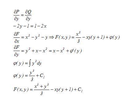

It's a total differential equation. It's how i solved it:
two or three combinations and you get it:
where C is real
It certainly is NOT an 'exact' equation (total differential) and the solution you give is not correct.
so where's an error?
[itex]P(x,y)=x^2-y^2-y[/itex], and [itex]Q(x,y)=-x^2+y^2+x[/itex], so
[tex]P_y=-2y-1 \neq -2x+1 = Q_x.[/tex]
y and x aren't constant
Really? Are you serious?
Did you even bothered to calculate [itex]\partial P/\partial y[/itex] and [itex]\partial Q/ \partial x[/itex]?
do you KNOW how to calculate Py and Qx?
Your remark makes it clear that you don't know how to take a partial derivative!
It isn't important, of course, that

[tex]\frac{\partial P}{\partial y} \neq \frac{\partial Q}{\partial x}[/tex]
False => False. Your hypothesis is wrong! Go back to the book and read REALLY CAREFULLY this time.
The least you should do this time is check your answer before claiming it's correct.
ok, sorry, no I've understood
So you firmly believe (a quote from your post) that
-2y- 1= 1- 2x? If so there is not point in trying to change your mind!
