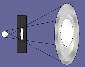

There is no need to invoke quantum mechanics for this issue. Diffraction issues will be the same whether you count photons or work the problem with classical electromagnetic waves and I think in this problem diffraction is not an issue. It all comes down to geometric optics.
Start with a finite width circular source behind a circular opening. You get two cones. Assume no reflectors and clean air. The inner cone is the cone inside which you can see the whole of the source. The outer cone is the cone outside which you cannot see any of the source.
{ See the attached image }
The region between these two cones (umbra) is where varying parts of the source are obscured and the brightness of the light will drop off to zero at the edge of the outer cone.
You get a reverse effect when you look at a shadow of say a circular object projected by a non-point light source. The edges of the shadow (umbra) will be fuzzy. This is the region between these two cones. You can treat the shadow as equivalent to the previous case where you allow the angles of the cones to exceed 180deg.In the case of say an actual flashlight with a reflector (widening the source and bringing it forward) the outer cone is actually the entire half-plane in front of the circular opening. You'll note that in looking at the front of a flashlight at any forward angle you see light. The reflector also projects a (usually out of focus) image of the source so the intensity is not uniform. If you want to test this, place some wax paper over the front of a flashlight to provide a uniform source and place the flashlight inside a box (painted black on the inside for best effect) with a circular opening.

Back on the OP a combination of all the factors mentioned in the above posts, (flashlight design, reflection off dust particles, the umbra effect assoiated with diffraction from edges and scattering of light from object illuminated by the cone) all conspire to make a perfect light cone very unlikely. Any 3D light rendering program trying to create a realistic effect would not create a perfect light cone without any illumination outside the light cone.

I don't think it's that difficult. As I say the umbra is not due to diffraction from edges but rather the width of the source vs the aperture. It can all be handled via ray tracing methods to give realistic effects. People keep bringing up diffraction here when the wavelength of visible light is so short vs aperture size that diffraction is not significant.
