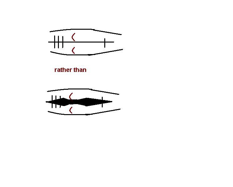

series of cones is just to describe the appearance of the shaft, i guess its pretty vague but i couldn't think of any other way to describe it.
i was actually hoping i could thread the shaft where the blades will be and secure them with knuts and washers but then comes vibrations and warping if there is even a slight displacement of the cg of the shaft cross section not to mention how aerodynamically inefficient this would make the engine.
i guess I am just going to need to build it the usual way then... oh well, too bad for my wallet...

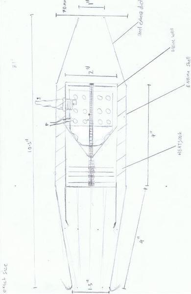

perhaps i should scan what I've drawn up so far and post it here?
Sure you can post it.
ok... here's the first general diagram, i would show all of them, i got diagrams for each part but with my laggy com and a scanner that scans the pictures into huge 87mb files(changed the format to upload) it took me an hour and a half to get this onto my com.
this is just a general overview.

Your explanation was still a bit vague, TC. I assumed from you first post that you wanted to make all of your turbine and compressor wheels the same diameter, rather than tapering the airflow. If that's correct, then you will be losing efficiency.
ah, yes! it was a bit vague but you understood it perfectly! i do understand there will be a great loss in efficiency but i suppose what I am asking is will it still provide a sufficient amount of thrust to get a small vehicle such as a gokart moving at a decent speed?

There is no way to answer any of these questions. If you are designing these from scratch, I challenge you to even get this thing made let alone get it running.
I got from your original post that you wanted to keep the shaft a constant diameter. Now it sounds like you are saying that you want the rotor disks to be equal in OD? Which one is it?
If you are simply talking about keeping the OD of the rotors equal that has no effect on anything. What you would have to do is to taper the inner flowpath to make sure the flow area decreases as you progress through the stages of compression.

here, this diagram should explain what i mean better.
i will test all those things out once i build it, i just want to be sure before i have the parts made that the loss in efficiency won't cause the engine to stop or not start at all. If the loss in efficiency will cause these problems then i will go back to the tapered shaft

I guess that I didn't understand after all. I thought that you meant...

ok, i guess you did not get the exact design but you still got the concept, both your diagrams and mine demonstrate the same compression effects even though obtained by tapering completely different parts... but yes, your first diagram is exactly what i was thinking of making
I think the conical sections help compress the inflowing air and create the expansion chamber for fuel mixture and then compress the mixture for ignition and exhaust. So do you think you are to have anything missing with your altered design?
