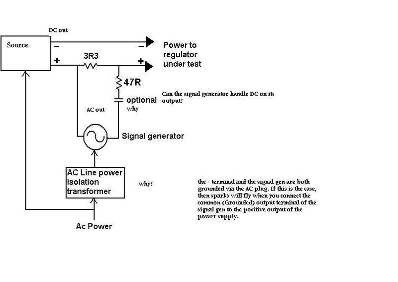

I'm trying to connect a signal generator as in the following configuration, my signal generator has an output port that i can connect to the capacitor in the diagram on a prorotype breadboard but what about the connection to the 3R3 resistor and DC supply? is there a special wire that goes from the signal generator output, splits into two that i can connect? or perhaps some kind of T-junction at the output port of the signal generator?
