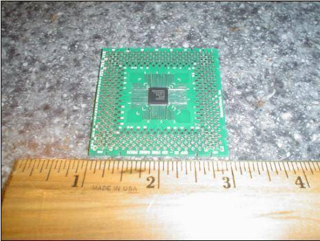

Hello All,
I'm wondering if anyone knows of any sockets that will fit an LFCSP (CP-56) surface mount package?
I want to put an AD9959 chip onto a protoboard and am wondering if there are any solderless sockets for it available. So far the only one I found was for high end processor chips and it costed like $500.
Right now, my current alternatrive is this E-Z board made from SMARTBoard.com here:
http://www.schmartboard.com/index.asp?page=products_qfp&id=70

Another option might be to just make some simple adapter PCBs youself. That would be a first step towards laying out and making a little more complex boards as you learn more and want to grow your projects. This company is used by a co-worker of mine to make simple-to-moderate complexity PCBs:
http://www.expresspcb.com/
You download their PCB layout tool, and order the PCBs through them. Their prices are pretty reasonable, and the resulting assembly is much cleaner and more robust than even using the Surfboard adapter things. For example, you can put a good ground plane and decoupling caps on a 2-layer board, along with your chip.

No, the links were just for resources to get you the blank PCBs. For the soldering part, you will need an assembly house to do that for you, but they won't generally take on small-size jobs like a couple of boards. There are folks like consultants who do small assembly jobs on the side. I know of an excellent lady who works out of her home here in Silicon Valley (with city permits), and does small-to-medium size assembly work. Her fine-pitch assembly soldering skills are first rate.
Are you anywhere near Silicon Valley? If not (EDIT -- Oops, I checked your bio later and saw Ohio, so the answer to that question would be no), I could maybe link you two up, where you could FedEx her the PCBs that you have done, and the parts, and she could solder them up for you and FedEx the assemblies back. It won't be real cheap, but it won't be expensive either. You can also maybe look in your local yellow pages for PCB assembly houses, and call a few to see if they have ideas on local places that can do just a few assemblies for you.
EDIT -- BTW, there are some basic pieces of equipment that are needed for fine-pitch SMT assembly work, and you might look into acquiring them as you do more work on your projects. You will need at least a medium-size microscope (preferably binocular for 3-D depth perception as you solder), and a good soldering iron like the Metcal RF irons. They are so much better than a magnetic Curie point soldering iron at keeping the tip temperature constant and hot. If you will be removing any SMT ICs, you will need a hot air gun with an attachment that matches the outline of the IC, and other simple stuff like solder wick braid strips. I also highly recommend an exhaust fan, or something else to pull the solder smoke away from you. We have several stations in our HW Lab with equipment like this, and I can do a fairly good job with SMT assembly and rework on my prototypes.
Another BTW, Jason. Does your EE department have an assembly/soldering station like I described, with a binocular microscope, Metal iron, hot air gun, tools, etc? If not, it sure seems like they should. Maybe ask around the department to find the best assembly/rework station that they have, and get permission to do some of your project work there. Honestly, the microscope and Metcal make a huge difference in what you can do.

Hello All,
I finally got the AD chip soldered onto this SchmartBoard EZ adapter that I bought. I had a tech at my school help me solder it to the board (see attached photo below).
@berkeman,
I still may contact your friend about soldering these things for me. Once I get the prototype board working, I'm going to order some nice PCBs so I might need her help later :smile:
