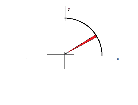

In the context of your question, "definite integral of area" doesn't make sense. You are calculating a definite integral to find the area of some region -- you aren't taking the definite integral of an area.
With parametric equations, we can represent the x and y coordinates as functions of a parameter, say t.
Here's an example of how they might be used. Consider the portion of the unit circle in the first quadrant. We know that the area of this quarter-circle is ##\frac \pi 4##.
We can parametrize the circle by the equations ##x = \cos(\theta), y = \sin(\theta), 0 \le \theta \le \frac \pi 2##.
Divide the quarter circle into thin "pie slices," each of area ##\Delta A = \frac 1 2 r^2 d\theta##. This is a formula you probably learned when you were doing integration with polar coordinates. Each of these slices is formed by two rays extending from the origin out to the circle, where the angle between the rays is ##\Delta \theta##.
The integral for the area of this quarter circle is $$\int_0^{\pi/2} dA = \int_0^{\pi/2} \frac 1 2 r^2 d\theta$$
Since r = 1 for the circle, the integral becomes ##\frac 1 2 \int_0^{\pi/2} d\theta = \frac 1 2 (\frac \pi 2 - 0) = \frac \pi 4##, which is what we expected.
