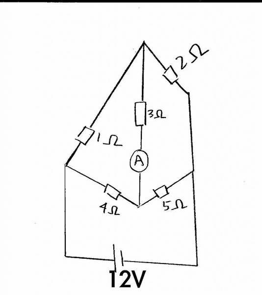

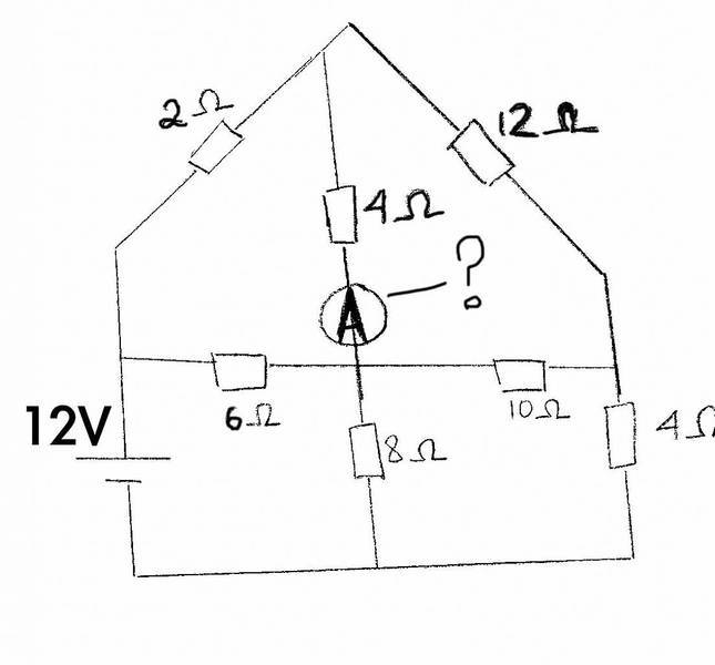

1. Find the reading of the ammeter
2. I've 2 questions here:
Link to the Attachement please,thx.
3. I had made a simplified diagram, but wasn't sure of the calculation.
Help me out with a complete explanation please~! Thx so much!

Show your attempted solution and you'll get help.
Hint: Use Kirchhoff's circuit laws
your simplified diagram is wrong. use kirchhoffs law, there is no shortcut, as it is neither a wheatsotone bridge nor symmetrical circuit.
