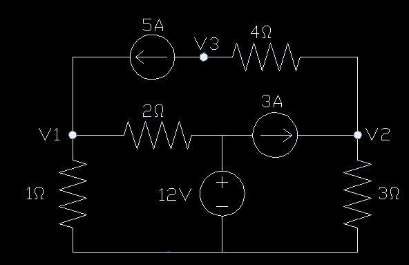

Find the voltages at V1 V2 & V3 in the attached circuit using node analysis.
Node analysis
I came up with a few equations for the variables:
V1(.5+1)-12(.5)=5
V2(.333+.25)-V3(.25)=3
V3(.25)-V2(.25)=-5
Solving I get V1:7.33V
V2:-6V
V3:-26V
I think I did it right but i don't see how i can get -26V when there's only 12 to begin with??

No mistakes alright.
The voltage source is not the only source of current.
There are constant current sources involved in the circuit as well. So there would be situations of V= I(current from voltage source + current from constant current source)R.
Sweet! thanks allot!
