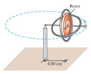

The rotor (flywheel) of a toy gyroscope has mass 0.140 kilograms. Its moment of inertia about its axis is 1.20 x10^-4 kilogram meters squared. The mass of the frame is 0.0250 kilograms. The gyroscope is supported on a single pivot with its center of mass a horizontal distance 4.00 centimeters from the pivot. The gyroscope is precessing in a horizontal plane at the rate of one revolution in 2.20 seconds.
(a) Find the upward force [tex]\vec{n}[/tex] exerted by the pivot.
(b)Find the angular speed w at which the rotor is spinning about its axis, expressed in revolutions per minute.

I'm new to gyroscopes, so if anyone can point me in the right direction and help me step by step, that would be great!
Bueler? ...Bueler? ...Bueler? ...Bueler?
part (a) =
(m_gyro + m_frame)g = 1.617N
part(b)---working on it
