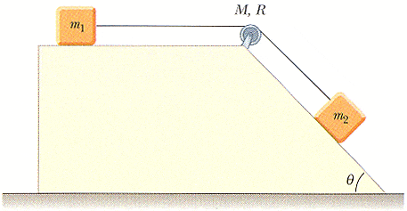

OK, I've done problems 1-3, but I'm having a real hard time with 4-6. Any help you guys could give me would be greatly appreciated!
4. Homework Statement
A block of mass m1 = 2.45 kg and a block of mass m2 = 5.55 kg are connected by a massless string over a pulley in the shape of a solid disk having radius R = 0.250 m and mass M = 10.0 kg. These blocks are allowed to move on a fixed block-wedge of angle θ = 30.0°. The coefficient of kinetic friction is 0.360 for both blocks. Draw free-body diagrams of both blocks and of the pulley.
(a) Determine the acceleration of the two blocks.
(b) Determine the tensions in the string on both sides of the pulley.
Left:
Right:
4. Relevant equations
[tex]\sum[/tex][tex]\tau[/tex]=RFsin[tex]\theta[/tex]
net [tex]\tau[/tex]=I[tex]\alpha[/tex]
I=.5MR[tex]^{2}[/tex]
[tex]\alpha[/tex]= a/R
4. The attempt at a solution
I drew a Free Body Diagram and used the given information to find that:
  • m[tex]_{1}[/tex]=2.45 kg
    m[tex]_{2}[/tex]=5.55 kg
    [tex]\mu[/tex]=.36
    R=.25 m
    M=10 kg
    [tex]\theta[/tex]=30
    n[tex]_{1}[/tex]=24.01 N
    n[tex]_{2}[/tex]=47.1031
    Force of Friction on M1=8.6436 N
    Force of Friction on M2=16.9571 N
    M1gsin[tex]\theta[/tex]=27.195
  • So some of forces acting on pulley is 1.5943 N to the right
  • So [tex]\sum[/tex][tex]\tau[/tex]=RFsin[tex]\theta[/tex]
    =.398575
  • Plug this into net [tex]\tau[/tex]=I[tex]\alpha[/tex]
    (I=.5MR[tex]^{2}[/tex])
    (I=.3125)
    .398575=.3125[tex]\alpha[/tex]
    1.27544=[tex]\alpha[/tex]
  • Plug this into [tex]\alpha[/tex]= a/R
    1.27544=a/.25
    .31886=a
This is wrong and I tried several different times, went over my work and I can't find what I did wrong.

This is where I'm unclear on what you've done. How did you get the a value for the net force on the pulley without knowing the acceleration? The tensions (forces acting on the pulley) are unknowns at this point because you don't know acceleration.

You seem to have the right idea, but since you haven't really shown the equations you used to sum up the forces it isn't easy to see where you went wrong.
You should have 5 equations relating all of the variables. Can you show them? For example, for M1:
[tex]N_1 - m_1g = 0[/tex]
[tex]T_1 - f_f = m_1a[/tex]
Do the same thing for M2, leaving everything in terms of the variables for now.
The next thing to do is sum up the torques on the pulley, which you do according to your equations [tex]\Sigma \tau = RFsin\theta = I \alpha[/tex] (remember that the forces are acting tangentially on the pulley).
Once you've done this, you'll be able to find for a by solving the system of equations.
