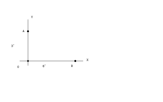

In the figure , the moment of a certain force F is 180ft - lb clockwise about O and 90ft-lb counterclockwise about B. If its moment about A is zero, determine the force.
Moment of a force
Mo = Fy(x)
Mo = Fx(y)
Since its moment about A is zero then the force passes through A down to the right because the problem mentioned its directions:
Moment of F w/ respect to O = 180ft - lb = Fx(y)
180ft - lb = Fx (3)
Fx = 30lb
Moment of F w/ respect to B = 90ft - lb = Fy(x)
90ft - lb = Fy(6)
Fy = 15lb
using Summation of components:
F^2 = (30)^2 + (15)^2
F = 61.8lb
the answer at the book is 75lb down to the right at theta = 36.9 degrees
is the book a typo?

your math is off...Fx = 60
What about the conrtribution of Fx(y)??
is the book a typo?
No
thanks for replying Phantom Jay
Moment of F w/ respect to O = 180ft - lb = Fx(3)
Fx = 60lb
I don't understand this part:
Since F passes through A... and you compute its moment w/ respect to O
Fx on this part is clockwise so it is a positive moment
Fy on this part is counterclockwise so it has a negative moment
Moment of F w/ respect to B = 90ft-lb = Fx(3) - Fy(6)
90 = (60)(3) - Fy(6)
Fy(6) = 90 - 180
Fy = 30lb
but when i put the counter clockwise as positive moment the answer would be 45 and the answer would be the same as of the back of the book...
is it because of the signs?

You have chosen clockwise as positive therefore counterclockwise is negative. Therefore, your equation should read, asuming Fy acts down,
-90 = 60(3) -Fy(6)
-270 = -Fy(6)
Fy = 45 downward
