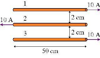

What is the force magnitude on the first, second, and third wires in the figure?
0L I1 I2)/(2πd)
μ0 = 1.2566*10-6
Substituting 0.5 as L, 0.02 as d and 10 as I1 and I2 I get 5*10-4,
which comes up as incorrect...what am I doing wrong?
thanks!

yea that us the formula i used...and i converted everything...the numbers i put in post 1 are the numbers i used for d and L respectivly
What is the correct answer? well...you would have to find the resultant force on wires 1 and 3...
idk the correct answer...
and since the wires are the same, wouldn't some cancel each other out? (due to the direction of the current)
well the force in the second wire zero
yes the force in the 2nd wire is zero, so you should have to only find the force of attraction of wires 1 and 3...
EDIT: thing to remember...like currents attract, opposite repel
So the just say that the first wire was going in the opposite direction to the other 2 wires... How would u calculate the force acting on wire 1 due to wire 2 (and wire 2 was going the opposite direction) and 3 ?
