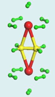

Last month at the International Symposium on Materials Issues in a Hydrogen Economy, held in Richmond, Virginia a new development in room temperature adsorption of large amounts of hydrogen (14% by weight!) was announced. The work was presented by Bellave Shivaram and Adam Phillips, of the University of Virginia.
Absorbing hydrogen at room temperature at these levels is a significant development. What remains to be worked out is if the substrate can be induced to easily give it back and if the catalyst (sorbent) can be recycled.
Titanium molecules complexed with ethylene, and bound to an inert support, created a thin film which strongly absorbed up to 14 per cent hydrogen by weight at room temperature. Most materials today absorb 7 to 8 per cent of hydrogen by weight, and that only at very low temperatures.
http://www.rsc.org/chemistryworld/News/2007/November/16110701.asp
The attached graphic shows how the complex is believed to function. The (green) hydrogen molecules are shown as ligands to (red) titanium atoms coupled to an (yellow) ethylene molecule.
