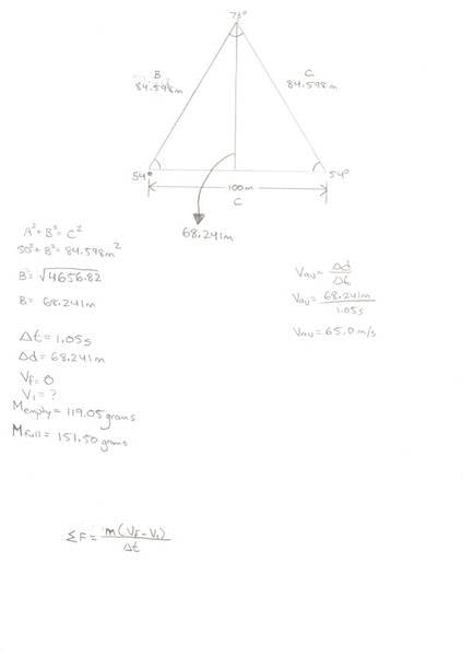

I get where shooting star is coming from but i need to find the net force of the rocket
so far all i know is my two inclinometer reader posted scores of 53 and 54 degrees with a time of 1.03/1.07 seconds the mass of the rocket and the mass of an empty and full engine
i can solve the net force but i need to verfiy the formula is correct or not
this formula came out of a Nelson physics 11 book i don't have access to the answer manual if i did it would tell me if this formula is correct or not
malty and I have given the same formula.
Does the book define what is net force? Why don't you tell us what is meant by that? It's also a good idea to state the problem completely and show what you've done so far.
See attached jpeg for my attepmt
I need to find the
F(thrust)
F(net)
Acceleration
Fg
Vmax
I can find Eg and Ek easily myself but the problem is with the rest

Vf would be zero becasue the rocket is at the top of it height
soooo... would Vi be 65.0m/s
If Vi is 65.0 m/s then using your formula
Fnet would equal 8372.878 Newtons**
** the (mass of the rocket full with engine)+(mass of the rocket empty)/2** is the mass of the rocket assuming the reaction is constant
am i correct?
The equation [itex]\bar F = m(v_f-v_i)/\Delta t[/itex] is a direct consequence of Newton's second law and the mean value theorem for an object with constant mass. That equation is not valid for a thrusting rocket since the mass of a rocket. You need to use the Tsiolokovsky rocket equation, [itex]\Delta v = v_e\ln(m_{init}/m_{final})[/itex]. For more details, see https://www.physicsforums.com/showthread.php?t=199087".
