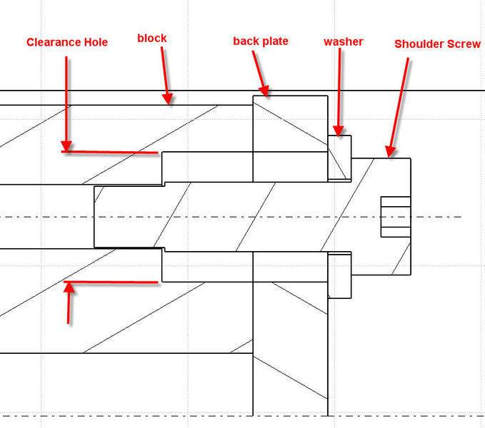

Dec18-07, 12:53 AM   #3
Thank you.
I have attached an image.
Can you please explain why shoulder screw is used in this application?
why an allen screw is not used?

Dec18-07, 05:45 AM   #4
Recognitions:
Science Advisor Science Advisor
Shoulder Bolts
It's impossible to tell you that without knowing the function of what it is you are showing us. I will tell you that an allen screw would not clamp any joint together. How would this joint maintain any kind of load with a set screw in it?
Dec28-07, 04:14 PM   #5
Quote by araanandv2 View Post
Thank you.
Is something missing here? There is an area adjacent to the shoulder which is unlabeled. Is that simply clearance (in which case it makes no sense), or is it a bushing of some kind? In either event, the washer is not doing much to transfer the load. Clearly no rotation is meant and, so, the whole purpose might be precise location. If that is the case, why not a reamed hole.
What is this thing?
Oh, wait a minute. Are these pieces insulators? Something like G10?
