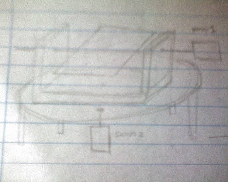

Hi there,
I'm an electrical engineering student currently building a 2 axis solar tracker. I need to build the frame and I'm posting here because I have no mechanical knowledge at all ...
The system is basically two motors, each for each axis which rotates a small solar panel (one rotates the panel up and down, the other rotates it left and right).
Example of how it would operate : http://youtube.com/watch?v=ayjVNouuIqQ
I need some ideas from you guys on how to have this kind of movement, ie. the arrangement of the motor, gear, pulley, etc. If you have any ideas or anything that I could Google to learn about, please leave a comment.
I was thinking maybe have a round base with a pulley for left/right. Not so sure yet about the up/down movement.
Thanks in advance.
Regards
Mel
Welcome to PF, Mel.
What sort of linkage between the motors and the pivot points is irrelevant (pulleys, gears, cranks, whatever). All that you need to do is have one entire system mounted on top of the other. For instance, if you use a turntable for your lateral movement, mount the whole elevation mechanism on it. No matter which way it's facing, you can tilt it however you want to. As an example of that, think of the gun/turret assembly on a tank.
Thanks for the reply, Danger.
What I want to ask is how do I actually build the elevation movement system and lateral movement system ? As I've said I have no mechanical knowledge, so I'm hoping you guys can give me a guide or point me in the right direction.
Thanks

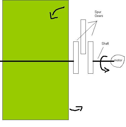

A worm gear and sector simply means that rather than a full-diameter driven gear, you only need part of one (think of a piece of pie rather than the whole pie). The worm itself is sort of like a screw thread, but the profile and pitch match the teeth of the sector. The gear ratio is determined by how many complete revolutions the worm has to make for a whole gear toothed like the sector to go around once, and can be very high. I can try to cobble up a rough sketch in 'Paint' if necessary; I don't have access to any real software since the wife spilled her coffee in my iBook.
I can't see the drive mechanism in your video, but it would appear to be a simple spur-gear train that rotates the axle. The thing that the guy keeps covering with his hand is definitely a light sensor of some sort, but I don't know about the probe attached to the panel. It might be another sensor that's part of a comparitor system.
In the picture below, is the drive mechanism a spur gear ? I attached a rough sketch below. Is this how it works ? If not, can you maybe sketch roughly how the drive works ?
Is the main difference between spur and worm drive is that for spur the output shaft is parallel to the input, and for worm drive it is at a 90 degree angle from the input ?
Sorry for the bad drawing !
No problem with the drawing; I just can't compare it to the photo because of the casing over the mechanism in the latter. I don't know how many gears in what configuration might be hidden there. Your picture is a perfectly valid interpretation.

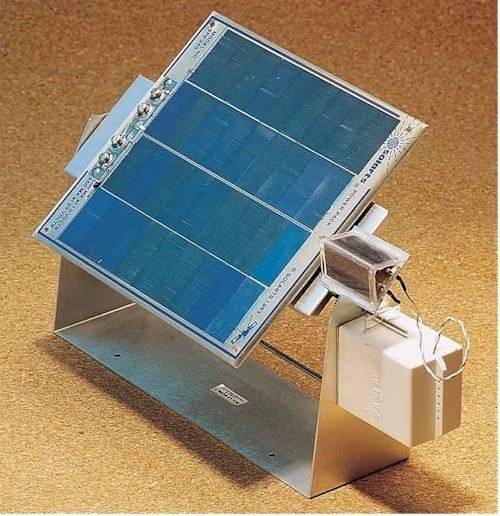

This is clever - it uses the suns heat to evaporate a liquid on one side of the mount which then condenses on the other side and the weight swings the panel around to the follow the sun, all without any power/computers/drives.
http://www.emarineinc.com/products/mounts/tracker.html
Now I'm just disgusted with myself for not thinking of that. Some things are so obvious in retrospect.
I thought you could do something with a bimetal strip - but this is much neater.
