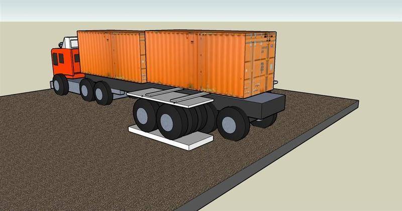

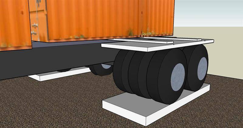

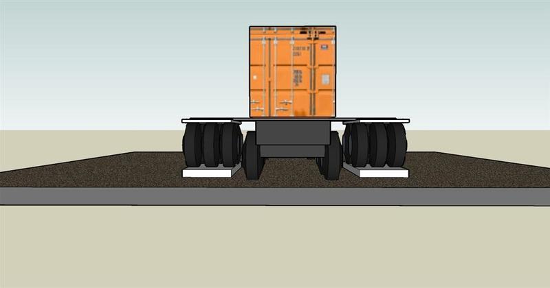

Container lift made out of used tires
I have enclosed pictures (quickly made in Sketchup) of how a dirt cheap design of a container lift might look like in principle.
I elaborated on the brilliantly simple idea mentioned by RonL, to lift and lower by adjusting the tire pressure. The lifts will work in pairs, on each side of the trailer/container. They will basically consist of used tires which are inflated and deflated by a compressor. In addition, the trucks own tire pressure could be adjusted too if needed.
What would the caveats and weaknesses be from an engineering point of view?
By connecting the vents of all the tires in the lift with a hose, their air pressure can be adjusted simultaneously. One could allow for trailers of different height by placing e.g. planks on the ground between the lifts. The drawings I made looks very flimsy for carrying a container weighting up to 20 ton. But by using more tires and attaching them in a good way should allow for enough stability. A hard structure could be used in the lift to stop the container from destroying the tires when they are completely deflated. And after the truck has left, hard structures could be placed directly under the container to carry some of the load and stop the container from accidently falling into the ground. Since the lifts can be moved between uses, ground wear can be distributed too. And so on.
Used tires are available very cheap locally. Air compressors are around too. They will almost be needed anyway in order to service the tires of the trucks before and after they cross the mountains. Compressors are cheap enough to allow for a backup. It feels much better to use money for salaries and purchasing stuff second and, than for importing expensive capital goods. You know, most of the governmental "aid budgets" end up at home in the donating countries as payments for goods and services exported to the "aid project". I believe that doing sound business is the best way to develop poor countries.
This starts to look like an interesting low investment cost project. The tranportation cost savings it could achieve, would stimulate more trade and transport on this route. The economic externalities could be disproportionatly large.
A project to install a "real" cargo terminal has been investigated by a large international shipping company, I have heard. But since it would cost several $100,000 to start up (pavement, forklifts, consultants), it would be ridiculously uneconomical with todays small traffic. It seems that they can't think outside the "thousands of containers per day" box.

Very good, and almost what i was thinking, also consider locking the upper plate, at the outside, to the base and have it hinge, you will get a lever action that will make the lift quicker acting.:wink:
