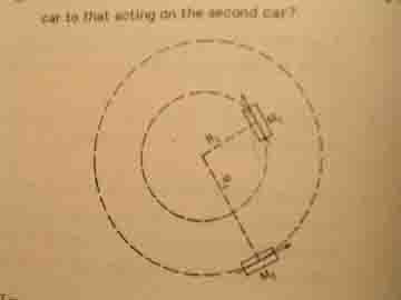

I really need some help with this question. Until now this is the first question I have ever seen like this and I am getting marked on it. here it is:
Two racing cars of masses M1 and M2 are moving in circles of radii R1 and R2. Their speeds are such that they each make a complete circle in the same length of time.
a) What is the ratio of the angular speed (measured in degrees of arc per second) of the first car to that of the second car?
b) What is the ratio of speed (measured in meters per second) of the first car to that of the second?
C) what is the ratio of centripetal acceleration of the first car to that of the second?
d) What is the ratio of the centripetal force acting on the first car to that acting on the second?
I have included the diagram, but it has a low quality. But it appears that R2 = 2R1 if that helps. I don't know how to do this if no values are involved.

I can't read your diagram, so I'll just give you a few hints.
A) They each make a complete circle in the same amount of time. So they're completing a full revolution in the same amount of time. What's angular velocity again?
w = 2pi/T
Hm... Same time...
B) v = wr
Combine this equation with the result from part 1.
C) a = r*w^2
D) I think you get the idea by now.

Hi there,
I understand that you are struggling with ratios of velocity and centripetal acceleration for two racing cars moving in circles of different radii and masses. Let's break down the questions and see if we can help you out.
a) The ratio of angular speed of the first car to that of the second car can be determined by using the formula for angular velocity, which is ω = v/r, where ω is the angular velocity, v is the linear velocity, and r is the radius of the circle. Since both cars make a complete circle in the same amount of time, their angular velocities must be equal. Therefore, the ratio of their angular speeds will be the same as the ratio of their radii, which is R1/R2.
b) To find the ratio of speed of the first car to that of the second, we can use the formula for linear velocity, which is v = ωr. Again, since both cars make a complete circle in the same amount of time, their linear velocities must be equal. Therefore, the ratio of their speeds will be the same as the ratio of their radii, which is R1/R2.
c) The centripetal acceleration of an object moving in a circle can be calculated using the formula a = v²/r. Since both cars have the same linear velocity, their centripetal accelerations will be inversely proportional to their radii, which means the ratio of their accelerations will be R2/R1.
d) The centripetal force acting on an object moving in a circle can be calculated using the formula F = mv²/r. Since both cars have the same linear velocity, their centripetal forces will be directly proportional to their masses. Therefore, the ratio of their forces will be M1/M2.
I hope this helps you understand the concept of ratios of velocity and centripetal acceleration. Remember to always use the appropriate formulas and pay attention to the given information in the question. Good luck with your assignment!
