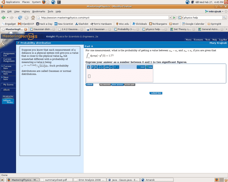

Hello, I am attaching what was an extra credit question in my physics class which I didn't understand at all. The topic isn't in the book and all the internet searchs I read confuse me. I was hoping someone might give me a walk through.
Thanks!

The problem states the integral value that is "under the bell curve" between x = - 1 and x = 1, for a Gaussian distribution with xm = 0 and σx = 1, which is the numerator of the probability expression (the denominator is [itex]\sqrt{2\pi\sigma^2}[/itex]). You should verify this by comparing the two formulas (the one on the left and the one at the top).
Since the integral is defined between -1 to 1, it is defined from xm - σx to xm + σx where xm = 0 and σx = 1.
Let [itex]C(\sigma)=\sqrt{2\pi\sigma^2}[/itex], then the answer is 1.7/C(1), for the standard Gaussian. Since [itex]C(1)=\sqrt{2\pi}[/itex] = 2.5, the probability is 1.7/2.5 = 0.68.
But I can convert the standard Gaussian random variable x (with xm = 0 and σx = 1) to any other Gaussian random variable (with an arbitrary xm [itex]\ne[/itex] 0 and an arbitrary σx > 0) by multiplying the standard one with σx > 0 then adding xm [itex]\ne[/itex] 0. For example, X = σx Y + xm where Y is the standard Gaussian and X is any Gaussian, with mean xm [itex]\ne[/itex] 0 and standard deviation σx > 0.
Let f(x;xmx) be the Gaussian density with an arbitrary xm and an arbitrary σx > 0. f(x;xmx) is identical to the formula on the left margin. The special case of standard Gaussian, f(y;0,1) is identical to the formula at the top of the page.
The conversion X = σx Y + xm does not affect the probability value as long as the bounds of integration (and the C value) are adjusted accordingly. Thus,
[tex]\int_{x_m-\sigma_x}^{x_m+\sigma_x}f(x;x_m,\sigma_x)dx\left/C(\sigma_x) = \int_{-1}^{1}f(y;0,1)dy\right/C(1) = 1.7/C(1) = 0.68.[/tex]
So the answer is 0.68 not only for the standard Gaussian but for any Gaussian distribution.
