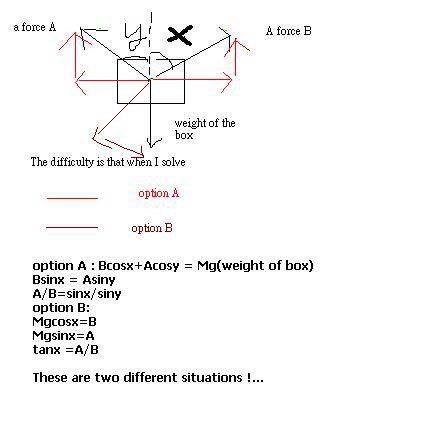

in normal situation, for convenience , we usually decomposed a vector into two components - horizontal and vertical.and setting up a series of equation to find out the answer...
but I am doubt if we can count up all the vectors to give a resultant vector that point to the direction of motion...(e.g. net force)
when do in practical, I found that this is impossible... but why ...
On the other hands, when dealing with more than three forces... I am confused in calculation because sometimes I am not sure which vector should be "decomposed"...
any hints/strategies when tackling these problems? Thanks :smile:

Can you draw a bigger diagram please? It's hard to see what's going on. But it doesn't look like you should be having problems with that example either.

I'm not clear as to what your question is. Since the system is in equilibrium, the net force must be zero. You can choose your axes any way you want, but vertical and horizontal work just fine.
Seems like you get the same answer either way, so what's your question?
Your answers are the same for both decompositions. Note that y=90-x, so that
A/B=sin(x)/sin(90-x) but sin(90-x)=cos(-x) and cos(-x)=cos(x) so that A/B=tan(x).

but the point is. can x+y =/= 90' ?
and for different cases, if you cannot practise the experiment, I am confused and 'afraid' to do these questions...

Let say when you have a small bob attached to the ceiling on one hand by a string...and then move it an angle to the vertical...
in this situation , we should decompose mg or tension of string on the bob ?
Tsinx =F
Tcosx=mg
tanx = F/mg
but if mg is decomposed
mgcosx =T
mgsinx=F ...

I assume "=/=" means "equals"? That's up to you--it's your diagram!
Regardless of what x and y are, you can always take components about any pair of perpendicular axes. And you'll get the same answer.

OK. You exert a horizontal force F that produces equilibrium at some angle.
Tsinx =F
Tcosx=mg
tanx = F/mg
OK.
mgcosx =T
mgsinx=F ...
I get:
Fsinx + mgcosx = T
Fcosx = mgsinx
Same thing: tanx = F/mg
As to which axes to use: Doesn't matter! By habit, I almost always use vertical and horizontal unless there's an obvious advantage in using some other set of axes.

for my decomposition of mg
I got mgcosx=T and mgsinx=F
if the question does not offer me the situation... it is possiblefor me to decompose like that
and then finally results will be tanx =F/T but not F/mg
T =/= mg
and I am worried about that

Which is incorrect. See my decomposition above.
You must find components of all forces along your chosen axes. F, mg, and T all have components parallel to T.

I think it should be related to direction of F as well ?
for example, when I put off my hand, the direction of acceleration... I am doubt...
for my way ,why T cannot be balanced by component of mg , leaving mgsinx which is further balanced by my applied force ?

Because you can't just forget about the component of F! You chose to use force compoents parallel to the string, so find the components of all the forces in that direction.
The bottom line: Since there's equilibrium, the sum of force components (all of them!) in any direction must add to zero.

oic ! I've got it
