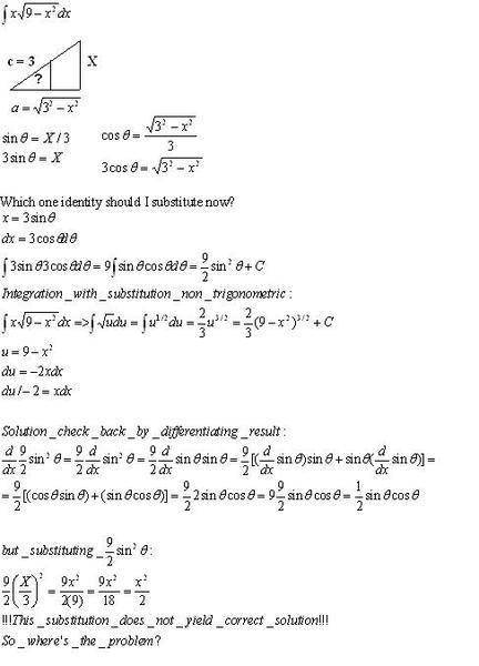

Given integral (I):
I[(x)sqrt(9-x^2)dx]
by words:
Integral of "X" times square root of "9-X(squared)
Use proper trigonometric substitution to solve this problem.

You don't even need Trig substitution.
[tex]\int x\sqrt{9-x^2}dx[/tex]
[tex]u=9-x^2[/tex]
[tex]du=-2xdx \rightarrow xdx=-\frac 1 2 du[/tex]
I know that I don't need that.
But the problem is, I have to use it.
The exercise require it.
Well you posted the solution to it? I don't know what else to tell you. Just analyze what they did. Work it yourself a couple times if you have to.
You forgot a term when you first did the substitution.
x = 3sin(u)
dx = 3cos(u)du
(9 - x^2)^(1/2) = 3cos(u)
So the integral becomes 27sin(u)cos^2(u)du
