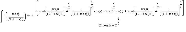

I doubt this is much use but I was having a little play with that on my maths program and it came up with the rather horrendous answer:
? hehe. It looked relatively simple?
Have I expressed your question correctly?
That expression can be simplified a whole heap!

True but even so it's not very pretty.
