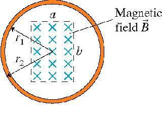

What is the magnetic flux through the loop shown in the figure

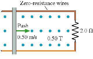

Problem 33.44
A) How big is the pushing force?
B) How much power does the pushing force supply to the wire?
C) What is the magnitude of the induced current?
D) What is the direction of the induced current?
E) How much power is dissipated in the resistor?

Problem 33.24
[tex]A = \pi r^2[/tex]
[tex]\Phi_m = ABcos\vartheta = \pi r^2 B cos \vartheta[/tex] probably wrong

Problem 33.44
A) [tex]F_{push} = \frac{v L^2 B^2}{R} = \frac{(0.5) (0.1)^2 (0.5)^2}{2} = 6.25 x 10^-4 N[/tex]
B) [tex]P_{input} = F_{push}*v = \frac{v^2 L^2 B^2}{R} = \frac{(0.5)^2 (0.1)^2 (0.5)^2}{2} = 3.125 x 10^4 W[/tex]
C) [tex]I = \frac{vLB}{R} = \frac{(0.5)((0.1)(0.5)}{2} = 1.25 x 10^2 A[/tex]
D) Using the right hand rule, the direction would be clockwise
E) [tex]P_dissipated = P_{input} = 3.125 x 10^4 W[/tex]

And 24: Very simple. THink of flux as the quantification of the magnetic field lines within a loop. Flux=BA. If the magnetic field is confined within the rectangle ab, then the area in which the field exists is simple. THe radius of the loop does not matter here, since the B-field is contained within the smaller area.

and would the magnetic flux be (in 24):
[tex]\Phi_m = AB = (ab)B ?[/tex]
That's how I see it.

Problem 33.44
I suspect there was some more text that went with this diagram, saying something to the effect that the bar is moving at a constant speed. This means that the net force on the bar is zero, and thus the applied force exactly balances the magnetic force acting on the induced current through the bar. (This is a phenomenon sometimes referred to as "magnetic drag".) This is what permits you to write the equation you have shown.
It seems to be absent from the diagram, but I take it that the sliding bar has zero resistance and a width of 10 cm. = 0.1 m. If this is so, your result is correct.
Since P = F · v , and the directions of the applied force and the bar's velocity are parallel, then you can simply write P = Fv . You've just worked out F, which is both the magnitude of the applied force and the magnetic force on the induced current through the bar, so you could just take your result from part A and multiply it by v to get
P = (6.25·10^-4 N)·(0.5 m/sec) = 3.13·10^-4 J/sec or W (0.31 mW).
The equation is correct (and, in fact, you'd have worked out this part before part A), but you've dropped a minus sign in your power of ten...
I see you've already hashed this issue out with Chi Meson...
E) [tex]P_{dissipated} = P_{input} = 3.125 x 10^4 W[/tex]
You have also dropped the minus sign in the power of ten here... (EDIT: As I look again, I see you did in Part B also.)
Ah, this statement is true, but you must demonstrate that it is! What is the current through the resistance in this loop? How much power will that resistance dissipate?

and yea, I forgot to include the desciption text in 33.44:
The 10-cm-wide, zero-resistance slide wire shown in the figure is pushed toward the 2 [tex]\Omega[/tex]resistor at a steady speed of 0.50 m/s. The magnetic field strength is 0.50 T.
Don't forget part E. It's true the power dissipated by the resistor must equal the power of the applied force, since the bar is only moving at constant speed (thus no change in kinetic energy). But this part of the problem is asking you to evaluate the effect of ohmic (resistive) heating in the 2-ohm resistor...
(I'm buggin' you on this because, if this were an exam, you'd get little credit for simply declaring that P_diss = P_input.)

[tex]P_{diss} = I^2 R = \frac{v^2 l^2 B^2}{R}[/tex]
You can see that Equation 33.6 (power input) and 33.7 (dissipated power) are identical. The rate at which work is done on the circuit exctly balances the rate at which energy is dissipated.Thus Energy is conserved
cse63146 said:
Not as much as you think. I got this from my textbook.
[tex]P_{diss} = I^{2} R[/tex]
This is the part I was asking you to show, which is straightforward and will agree with the result you got from the power of the applied force. (Just because the textbook states this doesn't mean you'll be allowed to do so on a test. If you were asked for Part E, the grader would want to see the calculation... I tell you this as a former TA and as an instructor.)
Oh, I thought you wanted me to derive it from scratch or prove it or something.
Oh, no, sorry if I caused you to understand my intention that way. What I'm saying is that you could do one of two things:
either take your result for [tex]I_{induced}[/tex] and use it in
[tex]P_{diss} = I_{induced}^{2} R[/tex]
to show that it has the same value as you found for [tex]P_{input}[/tex]
or take your expression
[tex] I_{induced} = \frac{vLB}{R}[/tex]
and use it in [tex]P_{diss} = I_{induced}^{2} R[/tex] to show that it gives the same result as
[tex]P_{input} = \frac{v^2 L^2 B^2}{R}[/tex].
As was mentioned earlier (and as your textbook points out), I imagine you could also use the argument that, since the bar, under the applied force, advances with a uniform speed, there is no change in its kinetic energy and thus no net work is done on it and no net power is applied to it. This shows that [tex]P_{diss} = -P_{input}[/tex]. But in our hypothetical exam problem, you would have to offer this physical argument.
