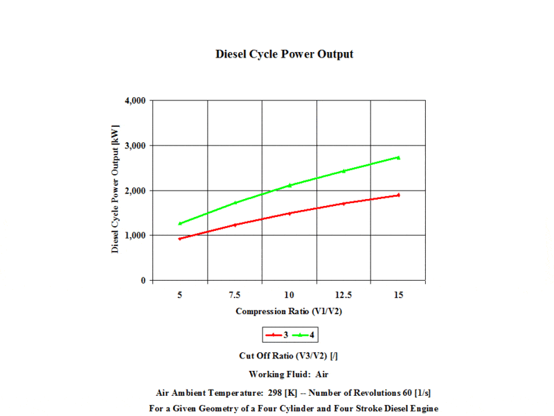

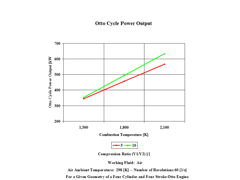

Hi
Can some one help me out on how to calculate the work done by a cycle/heat engine?
I am looking to calculate this in a graphical form, using P-v diagram and a numerical form, using an equation of work.
I have state/process data for for cycle for volume an pressure for point 1-2/2-3/3-4/4-1.
I have a compression and expansion index.
If anyone could help me out with the equation to use i would be real happy.
If anyone can point me in the direction of some further reading on this subject i would be greatful too.
What kind of cycle? Get your air tables out and look up the enthalpy/energy values.
Then you calculate the net work as a sum of the difference in enthalpies for the points that generate or input work.
The Cycle would be "Otto" or "Diesel" heat engine.
I think i have the formulas.
Constant Volume: W = 0
Constant Pressure: W = P(V_2 - V_1)
Constant Tempreture: W = P_2 * V_2 * ln (V_2/V_1)
However, i am unsure if i am working with an ISOTHERMAL process vs POLYTROPIC process.
The pressure increases whilst the volume decreases, does this indicate Polytropic or Isothermal
Hi there:
Check out your post on compression and expansion.
The same material covers this post.
Here are two plots regarding the performance of Otto Cycle and Diesel Cycle.
Thanks,
Gordan
