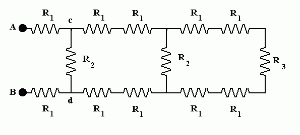

A number of resistors of values R1 = 5.0 Ω, R2 = 98.0 Ω, and R3 = 16.0 Ω are connected as shown in the figure. What is the resistance between points A and B?
Ok so the 4 R_1's and R_3 are in series on the end which gives a resistance of 36.0 ohm. This resistance is in parallel with R_2 so it's 1/ (1/first resistance + 1/R2 ) =26.3ohm. The 4 R1's and R2 are in series so its R1(4)+R2 =118. Now this resistance is in parallel with the first R2 so its 1/ (1/118 +1/98)= 53.5ohm + the 2 R1's at the start = 63.5
So 63.5 ohm + 26.3 ohm = 89.8 ohm but this isn't right. Can someone help me out please.
Redo that last step. The 4 R1s are in series with the effective resistance calculated in the previous step, not with R2 alone.
so R1(4) +R2 + 26.3 ohm= 144.3 ohm, so then do I just follow the steps I have already used?
No, you're still making an error. As you work from right to left, you replace resistors with their equivalent resistance.
(1) You replaced 4R1 + R3 with their equivalent = 36 ohms
(2) Now R2 & 36 ohms are in parallel, replace them with their equivalent = 26.3 ohms
(3) Now you have 4R1 in series with 26.3 ohms (not R2; R2 is gone!)
... and so on
Oh ok ,I understand it good now, thank- you very much!
26.3ohm+4R1= 46.3
Parallel with R2 so 1/ (1/98+1/46.3)= 31.44ohm + 2R1 on the very left = 41.4 ohm :)
You got it. :wink:
Ok so there's another part of the question I'm having trouble with I worked through it but its the first time I've seen anything like it.
A-C was I1, C-D was I3 D-B was I1
I1-I3=0
I3-I1=0
I1-I3=I3-I1
2 I1-2 I3=0
I3=I1
E-I3R-I1R=0
E=I1R-I1R=0
E-2I1R=0
E= (2I1R)/(2R) I1=E/2R= 110.0V/2(98.0ohm) = 0.561A
I1-I3=0
At junction C (or any other junction) it's the total current flow that must add to zero. You counted the current from the A-C (I1) and D-C (I3), but what about the branch going to the right out of C?
What are you given for this part of the problem? The total voltage across A-B? If so, do the opposite of what you did before. This time work backwards from left to right, using the results of your previous work to find the various currents.
So are my working relevant at all? Or do I need to scrap them completely and start over?
Start over. Your first equation, I1-I3=0, is incorrect.
kk I've got work so I can't solve now, Ill be back later, you may not be here but thankyou very much for the help today!
So will my first equation have to consist of I1,I2,I3,I4,I5,I6 because of the complexity of the circuit?
