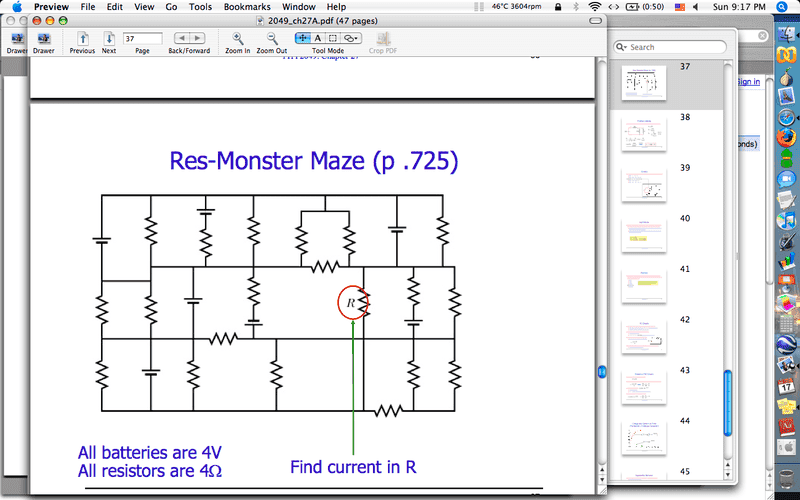

See image. According to Halliday, Resnick and Walker this question takes only a couple of minutes of mental calculation.
V=IR i guess
I tries for hours but no loop..

Hi sai2020,
When you write out Kirchoff's loop equation for a circuit with only resistors and (ideal) batteries, if you know the values of the battery voltages and the resistors, the only unknowns in your equations are the currents. And the currents in the loop equations only show up when your loop passes through a resistor.
So, looking at your picture, can you start at the resistor, and find some path, following wires through the circuit, that only passes through batteries and ends up back at the resistor? If you can, then writing the loop equation for that path would only have one unknown--the current in the resistor that you are looking for. So what do you get?

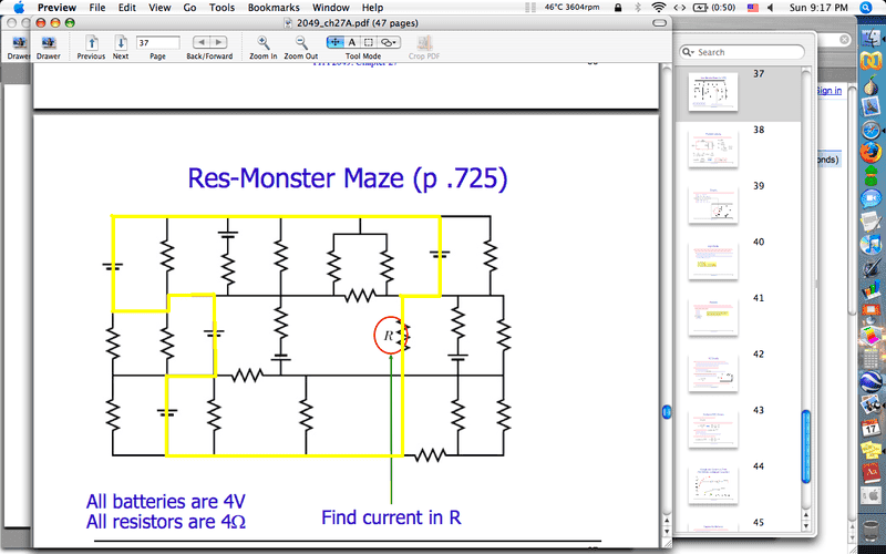

NO! sorry for the screaming, but current is measured in amperes, not coulombs. it does make a difference.(2 is correct though). and Shengzhoumi, current will not always pick the easiest path to flow, it will split up depending on the individual resistances, in fact the solution requires you to go over a resistor, namely R, so your argument that it will have no resistor's is very flawed. what you described was a short circuit. the reason that is the path to follow is that according to kirchhoff the sum of the voltage drops will add to zero in that loop.
look properly, there is a loop with only that resistor and batteries.
Look at the loop highlighted, it has only the resistor across which current is to be measured, and the cells!

To those of you who don't see from the implication, I shall expand.
Look carefully at the circuit, the three emf on the left of the circuit are moving the charge in the clockwise direction, and the one emf on the right is the opposite direction.
So for the sum of emf, don't forget to make the opposing emf have the opposite sign.
Then i = (ε net)/R is self-explanatory.
The devil is in the details :)
but how is it that when 4 batteries of 4 v each r connected...u get the net emf to be 8 v
ooops sorry...now i understood...that battery connected in opposite order will have opposite sign

It doesn't matter what's in parallel with an ideal source (unless it's another ideal source with a different potential, and then FZZZSST! BANG!). Nothing in parallel with that resistor will change the potential across it that's set by the indicated ladder of ideal voltage sources.
