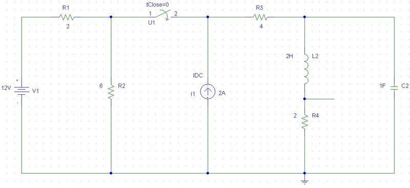

It is in the attachment.
NOTE: I supposed I did a little mistake when I drew the circuit with PSpice. The closed switch should look like .---->. instead of having that 45 angle. I don't know if it matters or not, so yea..

Okay, well, I'm trying to solve this second order transient circuit, but I have a problem! I can't find the correct equivalent resistance. What I do first is to remove the voltage source by a short and the current source by an open circuit. Now, I got to find the equivalent resistance to calculate α. What I do is;
R12 = (2 * 6) / (2 + 6) = 1.5 ohms
then;
Req = R12 + R3 + R4 = 1.5 + 4 + 2 = 7.5 ohms
According to the book, the Req should be 2 ohms! So either, I'm doing something really wrong, or there's a mistake with the book. Can someone please help me?
Any help would be greatly appreciated.

mm, well, i figured out what was wrong.
since the switch is closed, i need it to open it to find the equivalents R, L, and C to check if its an series RLC or parallel RLC.
i opened the switch, and took out the sources, everything cancels out, and i'll have only the rightmost loop with the 2 ohm resistance, 2H inductance, and 1F capacitance.
anyway, could someone tell me if I am right or not?
