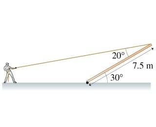

A man is attempting to raise a 7.5 m long, 29 kg flagpole that has a hinge at the base by pulling on a rope attached to the top of the pole. The figure of the problem is below as an attachment
With what force does the man have to pull on the rope to hold the pole motionless in this position?
[tex]\tau[/tex]=F*r[tex]\bot[/tex]
Net torque = 0
I tried finding the torque caused the weight of the flagpole, and then the torque caused by the man. From that I tried finding the force which the man exerts. But I can't find the correct answer.
Torque from gravity = w*r[tex]\bot[/tex] =mg*Lcos([tex]\Theta[/tex]) =(9.81*29)*7.5cos30 = 1848 Nm
Torque from the man = F*r[tex]\bot[/tex] = F*Ltan[tex]\Theta[/tex] = F*7.5tan20 = F*2.73m
The two torque values should equal each other. so...
1848 Nm = F*2.73m
F= 1848 Nm / 2.73
F= 676.8 N

What is the question asking for? You haven't really stated that.
Your general method will work assuming your trying to find equilibrium (i.e. the pole isn't moving).
The problem with the details of your calculation however, is the gravity.
For any uniform (in density) object, you can treat the force of gravity as acting on the center of mass (not the end of the pole which you have done in the equation).
It might help if you draw a free body diagram of the pole, to help visualize the difference in radii.

The question is:

(You haven't said, but I assume you're taking torques about the end of the pole on the ground).
In the first equation, you only need half the length (as lzkelley says)! :rolleyes:
In the second equation, I suspect you've drawn the wrong right-angled triangle … it isn't tan20. :smile:
