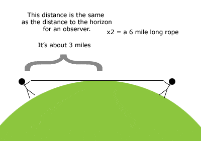

In a nutshell: Two people, standing a few meters apart facing each other, are holding a rope taut. Assuming the rope is infinitely long, the people are 'infinitely strong', so they may hold any length of rope, and that they could walk all the way around the earth...
If the two people walked backwards, all the while holding the rope taut, until they were standing back to back on the other side of the Earth, would the rope touch the Earth at any point, or would it be taut and above the surface of the Earth at every point?

The rope touches the earth. Draw a diagram and figure out how far apart they will be when the rope touches.

I've been working on the calculation, but I can't seem to make any progress. According to Google, the radius of the Earth is 6,378.1 km, but needless to say that's an estimate. If we approximate pi to 3.141592, the arc length of 1 degree is 111.318822 km. This leads to the question, not of how far we can see into the horizon, but of how many meters, (or km?) a 'rope' above Earth will 'drop' per unit arc length (presumably 1 degree, for simplicity.) If anyone has any other suggestions or calculations that can help, they would be much appreciated. This is driving me nuts right now!

All you need to know is the distance to the horizon for a 5 foot tall person (i.e. a 6 foot tall person at their shoulder height).
According to this http://boatsafe.com/tools/horizon.htm the horison is about 3 miles away, mking the rope 6 miles in total.

I don't see why u have to go drop/unit arc length. If u just want to know how far u go to flush your head (meaning what is the arc length to have a certain drop) with horizontal surface, then subtract the radius from the height, use it as a leg and the radius as the hypotenus to find the angle by cos(theta)=(radius-ft drop)/radius . From theta u can find the arc length using r x theta.

What?? No!
Please see diagram!

Thanks, DaveC426913. After doing some background research on what you said, I realized that makes complete sense. I was trying to somehow factor in the gravity affecting the rope, which makes no sense, since if the rope was taut it would be completely straight. (Assuming it's all hypothetical, wouldn't collapse under it's own weight, etc.) If we say the level of the rope is the level of our eyes, and plug that into a formula to find distance to the horizon, that gives us the distance from us to the point where the rope touches the surface. Multiply by two, as you said, and you have the total distance of the rope between the two people.
Problem solved! Thanks again everyone for your help!
