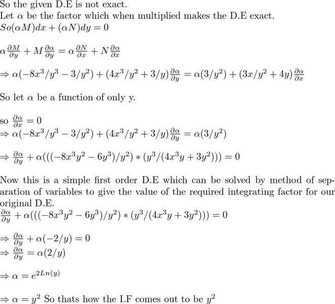

,find an integrating factor and then solve the following:
[4(x3/y2)+(3/y)]dx + [3(x/y2)+4y]dy = 0
u(y)=y2 is a valid integrating factor that yields a solution x4+3xy+y4=c
,no clue how though!

Um, doesn't multiplying the entire expression by y^2 gives you a form which is exact? Why do you say you have no clue when you know the correct method? Once you have reduced the DE to an exact one, then you can simply find the potential function, which you appear to have already done. So what's the problem here?
...because the method of haphazrdly looking at the equation and thinking, "what will make this exact?" isn't exactly a method that will work all the time. And the method presented in the book and class yields factors that would simply suck trying to integrate.
I was just curious if there were any other strategies that anyone knew of.
,so as a revision to my original post... I understand how and why y2 is a factor - I just don't exactly see how it was reached.

I can see why y2 is an integrating factor, but I don't know how this answer can be derived. Do you use:
[tex]\frac{N_{x}(x,y) - M_{y}(x,y)}{M(x,y)}[/tex]
Where M (x,y) = 4(x3/y2)+(3/y)]dx, and N = 3(x/y2)+4y dy
When I try and solve this, I get a very complex integrating factor.
See the attachment for how [tex]y^{2}[/tex] comes out as the integrating factor for the given D.E
