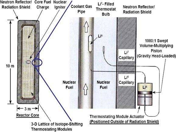

I'd like to see their idea for reactivity control.
I also have to wonder about the feasibility of this in regards to control systems. How would you be able to control the reactor without movable control systems?

Old thread, but interest is high w/ company about ready to launch to commercialize. Here's the reactivity control from the paper (Lithium 6 and 7):
Hyde said:
Located throughout the core's fuel-charge in a 3-D lattice whose cell constant is roughly a mean free path of a median-energy-for-fission neutron, each of these modules consists of a pair of metallic compartments, each one of which is fed by a capillary tube. The small thermostat-bulb compartment located in the fuel always contains Li7, whose neutron absorption cross-section is essentially zero for neutron energies of interest, while the relatively large one positioned in a cooler location on the wall of a coolant tube may contain variable amounts of Li6, which has a comparatively large neutron absorption cross-section. [Lithium, melting at 453 K and 1-bar boiling at 1615 K, is a liquid across the entire operating temperature range of the reactors of interest, and its two stable isotopes each have useful nuclear properties.] As the fuel temperature rises, the thermostat-bulb-contained Li7 expands, and a small fraction of it is expelled (not, vert, similar10−3, for a 100 K temperature change), potentially under kilobar pressure, into the capillary tube which terminates on the bottom of the cylinder-and-piston assembly located outside of the radiation shield and physically lower than the Li6 intra-core compartment. There the modest volume of high-pressure Li7 drives a swept-volume-multiplying piston, which pushes a three order-of-magnitude larger volume of Li6 through a core-threading capillary tube into an intra-core compartment adjacent to but cooler than the thermostat-bulb, which is driving the flow. There the Li6, whose spatial configuration is immaterial as long as its smallest dimension is less than a neutron mean free path, acts to absorptively depress the local neutron flux, thereby reducing the local fuel power density. When the local fuel temperature drops, Li6 returns to the cylinder-and-piston assembly under action of a gravitational pressure-head, thereby returning the Li7 to the thermostat-bulb whose now-lower thermomechanical pressure permits it to be received. A total loading of ≤ 104 mol – ≤ 60 kg – of Li6 is sufficient for the filling of the not, vert, similar103 thermostating modules of the reference 1 GWe-reactor.

Also appears the Lithium control system is out. Now back to B4C control and safety rods, HT-9 fuel clad (Slide 34)
