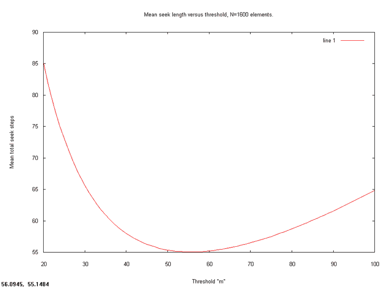

I'm pretty confident that the sqrt(2n) solution is correct. I just wrote a really quick and dirty simulation to test it. It shows, for the case of list size n=1600, the mean total seek length versus the threshold "m", for m = 20 to 100 with the mean taken over 1000000 runs for each value of m. (See attachment).
