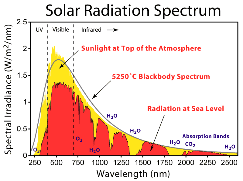

Image from wiki solar radiance article:
Can't include image in the post, so you have to click the link. Looks like at the sea level about 1/3 of energy is in the visible range (area was eye-integrated, so don't quote me). That means around 2/3 in the IR - but different coatings will be able to reflect IR in in different ranges, so things get more complicated.
