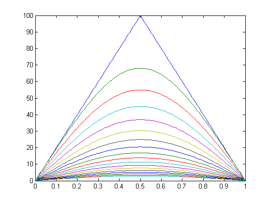

I am a little confuse here. I am trying to solve the 1-D Transient Heat Transfer for a Constant Temp. Surfaces "wall".
The PDE is
[tex]\frac{\partial T}{\partial t}=\alpha \frac{\partial ^2 T}{\partial x^2}[/tex]
T(to)=200*x
I am not so sure about how I'm suppose to get the Temperature profile
any help?
-link

Yes, T=T(x,t) T(x,0)=200*x for 0<=x<=.5L (symetric at 0.5L) T(0,t)=0 T(L,t)=0
No, not separation of variables..
The problem was that I was using the finite difference method to find the temperature profile in the wall at different times and I had two equations for the problem but I didn't knew which one was useful.
Here are the equations
[tex]T_m^{p+1}= Fo(T_{m+1}^p+T_{m-1}^p)+(1-2Fo)T_m^p[/tex]
Subscript are for spatial nodes.
Superscript are for the time nodes.
[tex]T_m^{n+1}-T_m^n=\frac{Fo}{2}(T_{m-1}^{n+1}-2T_m^{n+1}+T_{m+1}^{n+1}+T_{m-1}^{n}-2T_m^{n}+T_{m+1}^{n})[/tex]
I found that both equations are good for solving the pde using finite difference.
Thanks siddharth
PS This how should look, (axis are not labeled...:P)

OK. Both are different FD schemes of the problem.
The first one is explicit in time* so you shoul be aware of the CFL condition that ensures stability.
The other is the Crank-Nicholson type discretization which is stable but needs system solver. In this one you have to collect unknown values (i.e. the values for the new time step which are indexed as n+1 here) to one side and solve the resulting Ax=b type linear system. This is an implicit form(*)
* Explicit in time. Values for the new time step can be obtained by direct substitution of previously known values. Spatial derivatives are obtained from the n-th time step.
* Implicit form. Spatial derivatives involves unknown values of the n+1st time step.
