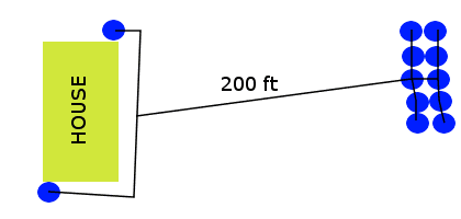

I had an idea to collect rain in large amounts in rain barrels for use in irrigation for my lawn and garden. I want to create a network of 30 rain barrels at 55 gallons each. I will put one rain barrel at each of my down spouts on my gutters, to catch the rain. Then I will have the rest, 28 barrels, 100+ ft away from the catching barrels at the back of my property. I was planning to connect the 30 barrels to a shared 1" backbone pipe that will connect underneath each barrel and run under ground.

My question is, will gravity evenly disperse the water to all the barrels, or will I end up with more water in the catching barrels vs the network in the back, or vice versus? Basically my hope is that each barrel will fill up evenly with the others to maximize water collection. Any thoughts would be greatly helped.

Here is a "better" diagram. The point I'm curious about is the effect that the large distance between the network in the back and the catcher barrels will have. Note: The network in the back will be 28 barrels. It is drawn as 10 to save space on the diagram. The catcher barrels by the house will indeed just be one on each side as shown.
For this question, I think we can just assume the barrels are all approximately at the same level.

Hmm, not quite what I was after. Could you do a drawing showing the vertical levels of all the necessary pipework? What level/gradient is the guttering at? How about the long runs of pipes?
I don't have very good software to make diagrams. So I will try to describe it a little better. Assume all of the barrels are at vertical level 0ft. The pipe is 1" pipe that goes directly out the side of the base of the barrel for 3 in then down at a 90 deg angle for 2 ft, where it connects to the backbone pipe. The backbone pipe will be completely at -2 ft. The house is 75 ft wide and 40 ft deep. So the two catcher barrels are 115 linear feet apart on the backbone pipe. The network of barrels in the back are all less than 2 feet from each other making a rectangular grid. The grid is 200 feet from the closest connecting point of the backbone of the two catcher barrels. All the barrels will be hooked to the back bone in the way described before, 3 in out, 2 ft down.
If it makes a large difference, there is a slight grade up from the house to where the network of barrels will be in the back. Might be 1 deg or less.
If all the barrels are at exactly the same level, as you've described it the water will level itself out across all barrels. However, a 1 degree incline over 200 feet will raise those barrels by 3.5 feet, so (if these barrels are higher than the ones at the house) they'll all be 3.5 feet emptier.

I would say that the 1-inch pipe is too small. First, you need to decide how heavy a rainfall (in say, inches per hour) that you want your system to handle without the downspout barrels overflowing. Then you need to figure out how much of the roof surface will go to the downspouts, so you can figure out the flowrate (in gallons per minute) through the pipe to the storage barrels. Then you can figure out the pressure drop this flow will create, allowing you to see how much higher the level will be in the downspout barrels, relative to the level in the storage barrels. If the downspout barrel level you calculate is higher than the top of the barrel, that means the barrel will overflow (wasting rainwater you are rying to collect). And that means the pipe is too small.
If I understand your system, a 1 inch per hour rain will produce almost 30 gpm thru the pipe. If it is one inch pipe, the head would need to be 24 feet for each 100 ft of pipe. You say you have 200 ft of pipe, so the level in the downspout barrels would need to be 48 feet - obviously that's too high, so your one inch line is too small. for a reasonable head (around one foot) use 2 inch or even better, 2 1/2 inch pipe. The pressure loss goes as the fifth power of diameter - a huge effect. But remember - it all depends on the flowrate you want the system to accommodate without overflowing.

'Pascal's Law' is not applicable if there is flowing fluid in the system (like the water moving from the downspout barrels into the storage barrels).
Any slope of land shouldn't matter as long as your catcher barrel is as high as the tops of the storage barrels and the connecting pipe is not vented. Having the catcher barrels mounted so high could look odd - you might be better with a small 'hopper' mounted higher up the wall, rather than a barrel - with the whole system 'under a small pressure'. If your pipe it wide enough, there shouldn't be a problem getting the water to flow fast enough into the storage barrels.
