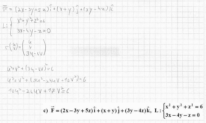

Hey.
I need to find the circulation of F through out the line L.
I know I need to use stokes theorem, the problem is, how do I find the area of L?
I mean, I know the intersection line of the sphere and the plot looks like an ellipse on the XY surface, but how do I find the boundaries? should I switch to polar?
Hi asi123! :smile:
No, it's not an ellipse:
L is the intersection of x2 + y2 + z2 = 6 and 3x - 4y - z = 0,
which is the intersection of a sphere with a plane,
so it's a circle.
And the plane goes through the origin, which is also the centre of the sphere.
Does that help? :smile:
