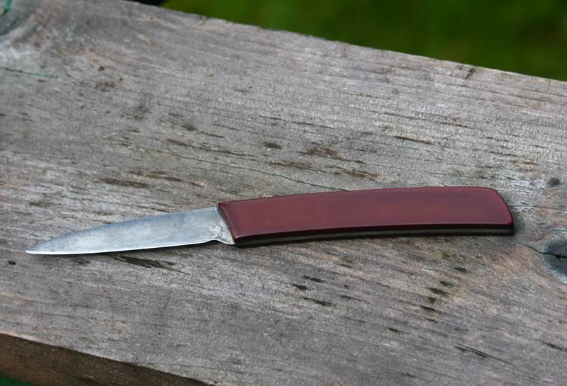

I have made a few knives using old blades. Get an old blade (saw blade, industrial blade of some type) and soften it so that it can be worked. Shape the new blade from the material, drill holes for mounting scales, etc, heat-treat, mount and sharpen. What's the hardest part to get right? Heat-treating, by far. I was using torches for heating, and it's very difficult to get consistent results that way. An older fellow I knew made knives using similar techniques, but he had an electrically-heated muffle furnace for heat-treating (he was also a goldsmith) and he got superior results.
Edit: Here is the hardest-to-heat-treat knife I ever made. It's a simple trout-and-bird knife with micarta scales. I made the blade out of a piece of Hyde industrial blade (paper-machine tail cutter). The problem is that the blade is so slim that it was tough to get even heating. After MANY tries, I finally got a blade that is flexible like a stiff spring, with a hard edge that is tough to sharpen.
