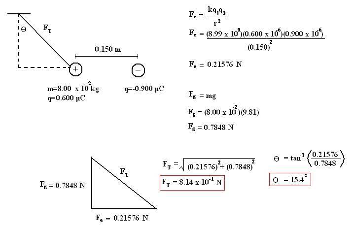

Find the force of tension and [tex]\theta[/tex].
[tex] F_e=\frac{kq_1q_2}{r^2}[/tex]
[tex]F_g=mg[/tex]
[tex]tan\theta=(\frac{opposite}{adjacent})[/tex]
Am I correct?
Does anyone need me to explain the problem?
Is there a reason why no one is answering my question? Because if there is I will try to do something about it, whether it is to restate the problem, or explain my work.
