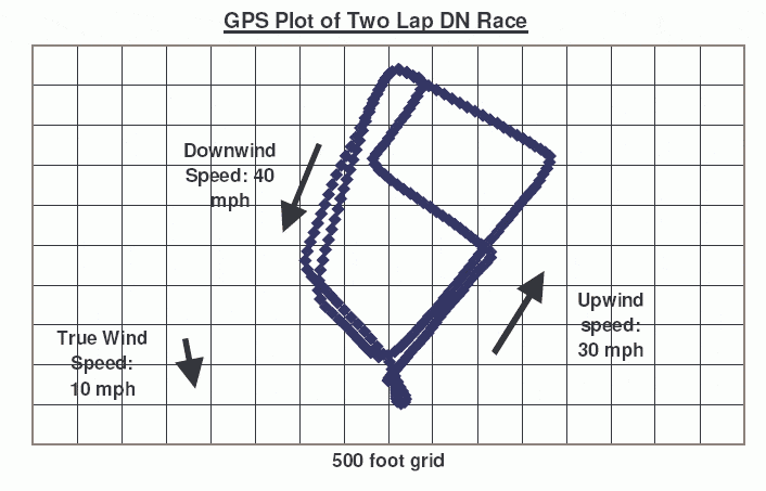

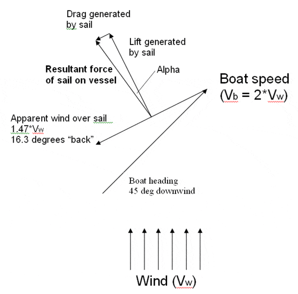

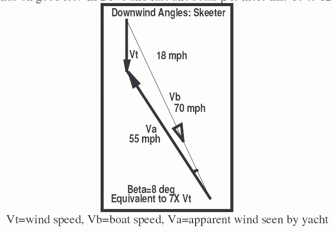

And a couple of diagrams from the article:
I'm well aware this doesn't relate *directly* to going STRAIGHT downwind faster than the wind, but once you realize your downwind component can be much faster than the wind, the steps to get to that nifty cart in the video are somewhat easier.
spork said:
Topher refuses to believe that ice-boats can maintain a downwind tack (at an angle to the wind) with speed sufficient to give them a downwind velocity component faster than the wind.
and he would be correct. The diagrams appear to be wrong. In the second diagram, the boat is probably going 8 degrees from perpendicular to the wind, not 8 degrees from parallel to the wind.
Assuming Vb of 70 mph, and an angle of 8 degrees downwind of perpendicular, the boat would be going 9.74mph downwind (a bit over 1/2 the downwind speed), and 69.32mph cross wind. Relative to the air, the cross wind component remains the same at 69.32mph, the "up wind" component (boat is moving downwind slower than the air) is 18 mph - 9.74 mph = 8.26 mph. The boats speed relative to the air or it's "apparent wind" is sqrt(69.32^2 + 8.26^) = 69.81mph.
And you base this on what exactly? This will be news to the iceboat community where they do it all the time. And how would you explain the GPS data?
Did you allow for "apparent wind" in determining this? The angle of the wind from the PoV of the vehicle will be quite different from the angle of the wind from an exterior PoV. (This is why sailboats seem to have a headwind when in fact, they're more like 45 degrees from head-to-wind).
I'm not sure about the underlying issue (I believe sailors actually do go downwind at an angle for the purpose of increasing their speed to their destination), but the GPS data does not support the contention. I don't know what the calculation is based on (there is no explanation of where the data came from), but it does not match the GPS output.
From that article: "Beta (β) is the angle between the apparent wind and the yacht vector." If Beta is small, then the apparent wind is mostly a headwind, with a small crosswind component:
If Va is 55mph, and Beta is 8 degrees as stated in the second diagram, then the apparent wind components, relative to the boat, break down into a head wind of cos(8) x 55 mph = 54.465 mph, and a cross wind of sin(8) x 55 mph = 7.655 mph. Still this doesn't give an overall picture of what's going on.
Wings divert the air, they don't accelerate air backwards in the opposite direction of travel. If the wind speed is 18mph, then the downwind component of the ice boat must be less than 18mph. If the speed of the boat is 70mph, the angle between wind direction and boat direction must be greater than 75.1 degrees (arccos(18/70)).
I'll research this and reply later.
I can't imagine how you come to that conclusion. The true wind is 10 mph, the ice-boat speed is 40 mph, and the angle between them is 35 degrees. That gives the ice-boat a downwind velocity component of 28 mph. That's nearly 3 times the wind speed.
In the vector diagram they show an ice-boat going 70 mph at 25 deg from direct downwind in an 18 mph wind. This gives the ice-boat a downwind velocity component of more than 63 mph (in other words 3.5 times the wind speed).

OK, I'll bite, or at least I'm intrigued. In order for this to work, the sail is going to have to divert air from the apparent wind direction to true upwind direction, while at the same time diverting air opposite of the true direction of the ice boat to generate thrust (relative to the ice boat direction). I can't figure out how to draw a diagram where this combination occurs. I'm taking into account that there are two sets of coordinates involved. The apparent wind (lift and drag), the true wind, and the true direction of the ice boat.
I've seen the equations from that forum thread, and some generic statements, but more data and a diagram would help here. For the diagram, how about the example that shows a true speed of 18 mph, an actual boat speed of 70mph, and apparent wind speed of 55mph. The diagram doesn't show the effective angle of attack (equivalent of a flat board with little drag) for the sail, what would the sail angle be in this case?
Take the caes of an ice boat going down wind, can you show the expanded equation for Vb, gamma and beta in this case? You'll probably have to use the two parameter form of arctan(y, x) to deal with the zeroes.
Let's assume an ice boat with a Beta around 8 degrees with a true wind of 5 mph due north. The goal is to maximumize Vmg due north. Could you break this down into the boat heading and the sail angle (both the true angle relative to north, and angle relative to apparent wind), and the Vb and Vmg achieved?

O.K. I'm back. And here's my diagram. This diagram represents an ice-boat on a 45 degree downwind tack (i.e. 45 degrees downwind as measured from the true wind direction - the wind direction a stationary observer would feel).
Now, as I said, this diagram will take some explanation. So here goes...
Unfortunately, I freehanded this diagram in M.S. Word. So it's not to scale. I can easily produce one to scale in another program if need be.
The vertical arrows at the bottom obviously represent the true wind speed and direction.
The lowest of the diagonal vectors represents the speed and direction of travel of the ice-boat. I have it here going downwind at 45 degrees, and moving at twice the speed of the wind. If my final force vector (after considering lift and drag as it operates on the sail) has any component toward the front of the boat, this tells us the boat will still be accelerating in that direction. When the net force is perpendicular to the boat's velocity (after accounting for lift and drag on the sail) the boat is on a steady state course. I show the former case here.
Note: the two key parameters here are the L/D (lift to drag ratio) of the sail (including the mast, chassis, etc.) and the L/D of the skates on the ice. I have intentionally ignored the L/D of the skates on the ice for two reasons. First to keep the diagram simple and easier to follow, and secondly, because the L/D of the skates can just as easily be lumped in with the L/D of the sail. If this is a concern I'll be happy to include those vectors on my next diagram. In any event, I think we should be able to agree that the ice-boat could be running on rails with low-friction wheels such that the L/D of the blades (rails in this case) would be so ludicrously high that we can ignore it.
A word on L/D:
L/D is literally the lift-to-drag ratio. On a wing (which is just a type of sail) the L/D also describes the glide ratio. So a glider that had an overall L/D (wing, fuselage, and all) of 30, would descend 1 foot for every 30 feet it moves forward.
More on L/D:
L/D is almost always a measured quantity - not a theoretical one. How it is measured is important to understand in order to understand the diagram. Lift is always measured as the force perpendicular to the free-stream (the relative wind over the wing - but not the disturbed wind in the immediate vicinity of the wing). Drag is always parallel to that free-stream and operates in the same direction (i.e. it opposes the velocity of the craft).
Now we come to the apparent wind vector. This is the vector whose tail is at the head of the boat's velocity vector. The apparent wind vector is simply the true wind minus the boat's velocity. This should make sense as you would expect to feel zero apparent wind on a boat that's going the same direction as the wind at the same speed as the wind. THIS is the vector that describes the wind seen by the sail (and everything else on the boat).
This apparent wind vector represents the free-stream that the sail sees. So we know the lift will be perpendicular to it and the drag will be parallel to it. You can see the "lift", "drag", and "resultant force" vectors drawn relative to the free-stream. The length of the "lift" and "drag" vectors is given by the L/D of the craft.
I don't recall what L/D I used for this drawing. It appears to be maybe 6:1 (I'll measure it if anyone cares). High performance sailplanes get 50:1.
So in the end we have the resultant vector acting on the vessel - against the keel/skates. If that force has a forward component, the boat can still accelerate forward from it's current state. I think you can see that if you extend the resultant force vector to the boat's velocity vector, it does in fact have a forward component.
If you wish to consider the L/D of the skates (the one part I intentionally left out), you simply have to compare the cross-component to the forward component of the resultant force vector. As long as that ratio is less than the L/D of the skates, you're still accelerating.
I hope this makes sense, but I realize it's may be difficult to absorb though vectors and verbage. It's a lot easier if I can wave my hands around and point at things.
I'll be happy to expand on, or clarify, any aspect as necessary.
