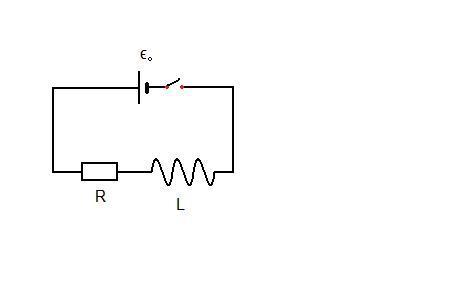

Give a definition of (self) inductance. Suppose a battery, which supplies a constant EMF ϵ_0 is connected to a circuit of resistance R and inductance L at t = 0. Find an expression for the current as a function of time.
V = IR
[tex]V = -L\frac{dI}{dt} [/tex<br /> <br /> <h2>The Attempt at a Solution</h2><br /> <br /> I am assuming that this is to be treated as a Kirchoff Loop, thus the total voltage = 0<br /> <br /> <i> Voltage providers: </i><br /> <br /> Inductor<br /> Battery<br /> <br /> <i> Users: </i><br /> <br /> Resistor<br /> <br /> Thus I have the equation:<br /> <br /> [tex]\epsilon - L\frac{dI}{dt} - IR = 0[/tex]<br /> <br /> and thus:<br /> <br /> [tex]\epsilon - L\frac{dI}{dt} = IR[/tex]<br /> <br /> treating like a differential equation:<br /> <br /> [tex]\epsilon - L\frac{dI}{dt} = IR[/tex]<br /> <br /> [tex]\epsilon dt - L dI = IR dt[/tex]<br /> <br /> rearrange:<br /> <br /> [tex]\frac{L}{IR} dI = -dt + \epsilon dt[/tex]<br /> <br /> Gives:<br /> <br /> [tex]\frac{1}{L}ln(IR) dI = -t + \epsilon t[/tex]<br /> <br /> multiply by L<br /> <br /> [tex]ln(IR) = -Lt + \epsilon t [/tex<br /> <br /> take exponentials:<br /> <br /> [tex]IR = e^{-Lt} + e^{\epsilon t}[/tex]<br /> <br /> Does this look right so far?<br /> <br /> TFM[/tex][/tex]

Hi TFM,
and thus:
rearrange:
This equation does not follow from the previous one.
No it doesn't
so:
see, I have to rearrange to get I onto the left side.
does this look better:
[tex]- L dI = IR dt - \epsilon dt[/tex]
[tex]- L dI = (IR - \epsilon) dt[/tex]
[tex]- \frac{L}{IR - \epsilon} dI = dt[/tex]

I think this part looks okay.

This isn't quite right. The integration is not right (if you take the derivative of the left side with respect to I you don't get the left side of the previous equation). Also remember that these are definite integrals, so you have to evaluate the limits.
Would the limits be for I between 0 and I and for t between 0 and t?

No, the integral
[tex] \int \frac{b}{x} dx \to b \ln x[/tex]
(plus a constant) because in that case the b can come out of the integral (it is not affected by the integration process at all). However, you do have to take into account that the R is multiplying the I.
[tex]- L\left( \int\limits_0^I \frac{1}{IR - \epsilon} dI \right) = \int\limits_0^t dt[/tex]

The R has to be handled like this:
[tex] \int \frac{1}{IR-\epsilon}\ dI \to \frac{\ln(IR-\epsilon)}{R}[/tex]
(plus the constant).
Also when you go to apply limits,
[tex] \ln (x)\Big|_{x_0}^{x_f} \neq \ln (x_f - x_0)[/tex]
Instead, it is:
[tex] \ln (x)\Big|_{x_0}^{x_f} = \ln (x_f) - \ln(x_0)[/tex]

[tex]-L\left[\frac{ln(IR - \epsilon)}{R}\right]^I_0 = t[/tex]
[tex]-L \left(\frac{IR - \epsilon}{R} - \frac{0R - \epsilon}{R}\right) = t[/tex]
[tex]-L \left(\frac{IR - \epsilon}{R} - \frac{- \epsilon}{R}\right) = t[/tex]
does this look better?
TFM
You seemed to have dropped your [itex]\ln[/itex]'s when you put in the limits.
Sorry, copied through typo :redface:
It should be:
[tex]-L \left(\frac{ln(IR - \epsilon)}{R} - \frac{ln(0R - \epsilon)}{R}\right) = t[/tex]
[tex]-L \left(\frac{ln(IR - \epsilon)}{R} - \frac{ln(- \epsilon)}{R}\right) = t[/tex]

What does that give for I?

This line is not correct, because:
[tex] \exp \left\{ \ln x + \ln y\right\} \neq x + y[/tex]
Before you take the exponential of both sides, you just want a single natural log on the left . That is, you want the left side to be just:
ln(something)
so:
[tex]ln(IR - \epsilon) - ln(-\epsilon) = -\frac{Rt}{L}[/tex]
isn't [tex]ln(a) - ln(b) = ln(\frac{a}{b})[/tex]
If so:
[tex]ln(IR - \epsilon) - ln(-\epsilon) \equiv ln\left(\frac{IR - \epsilon}{-\epsilon} \right)[/tex]

[tex]ln\left(\frac{IR - \epsilon}{-\epsilon} \right) = \frac{-Rt}{L}[/tex]
taking exponentials:
[tex]\frac{IR - \epsilon}{-\epsilon} = e^{\frac{-Rt}{L}}[/tex]
Does this look better?
TFM
Yes.
Excellent. So:
[tex]IR - \epsilon = \epsilon e^{\frac{-Rt}{L}}[/tex]
[tex]IR = \epsilon - \epsilon e^{\frac{-Rt}{L}}[/tex]

[tex]IR = \epsilon \left(1 - e^{\frac{-Rt}{L}} \right)[/tex]
divide by R:
[tex]I = \frac{\epsilon}{R} \left(1 - e^{\frac{-Rt}{L}} \right)[/tex]
Does this look correct?
TFM
TFM
That looks right to me.
