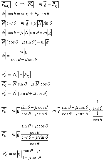

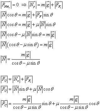

I recently ran into something between two teachers. For the longest time one has been teaching that when a car is traveling in circular motion on a banked track with friction, only the horizontal component of the friction force is to be taken into account, by adding to the centripetal force; the friction force of course being parallel to the banked track. However, another teacher has told me that the vertical component is taken into account, and this significantly complicates things. Since the car is not moving up or down along the incline, all vertical forces must cancel out. So the vertical component of the normal force must equal (in magnitude) the force of gravity and the vertical component of friction. But friction depends on the normal force. I've attached a diagram of the situation and the solutions, (using mathtype) as images to make sure you understand what each teacher is suggesting. What I want is a second opinion; do you take the vertical component of friction into account or not?
Thanks in advance.
Absolutely. All forces must be taken into account, including the vertical component of friction. (The first solution is incorrect.)

Determining if you can ignore a force is a simple matter of counting equations and unknowns.
Here, if you write the 2nd law equation for the horizontal components you have two* unknowns: the magnitude of the normal force and the magnitude of the friction force. You cannot solve one equation in two unknowns so you know that you must use the vertical components in order to get your second equation.
*There are two unknowns is assuming that the centripetal acceleration or force is given. Otherwise you will need a third equation.

The OP's confusion was due to the fact that one teacher thought you could ignore the vertical component of the friction force. I was just explaining the general method for determining when you can ignore a force or a component and when you cannot.

Thanks everybody, i was pretty sure you couldn't just ignore a force.
I've found a much more elegant way of presenting the solution for the second teacher's method. It's the same up till the part where the expression derived for the normal force is substituted in, and instead of doing that, this time i took out a common factor of the normal force before substituting, and then did some trig work to get a more elegant looking solution. Thought I'd share.
