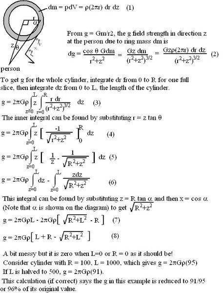

I just HAD TO work it out! See attachment. This work is way above my level (though I could have done it when I was a student), so I hope someone will check it. I noticed that a 2D integral works because you can do a ring of mass on one slice of the cylinder because only the axial component of g doesn't cancel out by symmetry. And for you first year young people, 2D integrals just mean you do the inner one and then you do the outer one. I evaluated it for a cylinder 1000 m long, 100 m radius. When the length is halved the g field at the end is reduced to 96% of its original value. Rather surprising, isn't it? I would have guessed something like 75% - instinct just doesn't work for inverse square laws.
Wow, NrQed, it must be exciting to be carrying on Feynman's work! I tried to emulate his high school teacher and found one or two students in my career who were interested in his path integral view of projectile motion.

Delphi51 said:
That makes good sense, Carid.
Your result seems correct. I just presented this problem to my professor and he did indeed say that you would have to integrate over the cylindrical region meaning take the force of gravity at every point on the solid that is interacting with the man!
Your conclusion certainly seems to agree with this notion.
