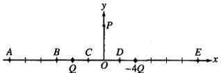

Particles of charge Q and -4Q are located on the x-axis as shown in the figure above. Assume the particles are isolated from all other charges.
2. Which of the following describes the direction of the electric field at point P?

E, it's attracted to -4Q, so it's direction would be toward -4Q, or -y and +x
3. At which of the labeled points on the x-axis is the electric field zero? (same picture as above)

I should put it closer to the charge with a lesser magnitude so I'm guessing B?
Yes, but it is also repelled by the Q charge, which will contribute something with positive x AND positive y components to the electric field. So I'd say you have to argue a bit more precise.
When in doubt, calculate.
I suppose you know the expression for the electric field, and by symmetry it is easy to see that the y-component is zero anyway. So you just need to consider the x-component for points on the x-axis; suppose the one charge is at x = 1 and the other at x = -1... what is the x-component of the total E-field as a function of x?
