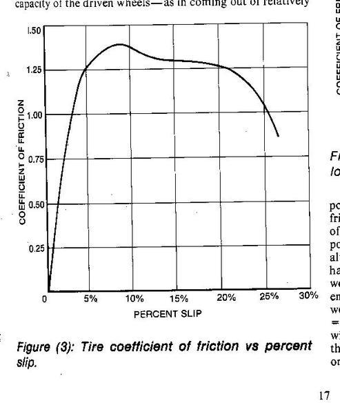

you are right about the answer but wrong about my post.
Tire coefficient of friction vs. slip angle is linear
Tire coefficient of friction vs. vertical load is linear
Tire force vs. vertical load graph is linear
if you read my above post...it confirms the heavier car moves first..

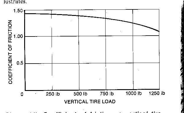

Not according to the wiki article which states that
Fy = c x Fz^s
Where
Fy = maximum horizontal force
Fz = vertical load
c = constant (not coefficient of friction)
s = load sensitivity exponent, in the range .7 to .9 (less than linear, 1.0 would be linear).
coefficient of friction = Fy / Fz = c x Fz^s / Fz = c x Fz^(s - 1)

Ok ..I got an open nuff mind to take another look ..tho in my business, knowing things are linear ( straight line in my feeble mind) to a point , then roll off is all i require.
My comments came from attached graphs we use to figure best handling combination. Again, things look pretty straight line to a point...but in my opinion
the best way to tune a race car is to design it with proper Roll Centers and CG located for max handling..all other tuning is band aid at track side to get best compromise when changing RC is not practical..
There is only one thing that wins races..tires , tires , tires...we tune the chassis to maintain MAXIMUM tire contact patch at ALL times on the track. The one that does this best, wins...

Ranger Mike said:
attached graphs
Look at the left graph. For a 2000 lb car, the average load per tire would be 500 lbs / tire. For the car with double the weight the average load per tire would be 1000lbs, and the coefficient of friction is signifcantly less according to the left graph.
