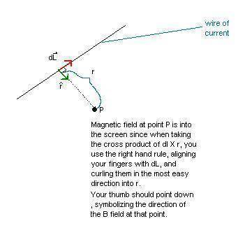

A few days ago my physics teacher told me that to find the magnetic field's direction in a wire you put up your right hand and whichever way your fingures bent was the magnetic field's direction, or at least that is what I understood. When I questioned him why this was the case he told me "because" and left it at that. Could someone tell me why this is the case?
I believe that you need to point you thumb in the direction of current flow. Your fingers then curl in the direction of the magnetic field lines. This is simply due to convention. We have defined the what positive current flow is, we have defined what the direction of the magnetic field is. This could just as well been a left hand rule. Perhaps the answer you are looking for then is "by definition"
yes, by definition

If you're looking for the origin of this definition, it comes from the experimental work of Biot and Savart, of Biot-Savart law fame. The law is:
[tex] <br /> d\vec{B} = \frac{\mu_0}{4\pi} \frac{I d\vec{l} \times \hat{r}}{r^2}<br /> [/tex]
yeah it's ugly, but what it tells you is that due to the properties of the vector cross product evident in:
[tex] <br /> I d\vec{l} \times \hat{r}<br /> [/tex]
The magnetic field vector B, takes off in a direction perpendicular to both the current element dl, which points in the direction the current moves, and the r vector which points at the field point you are calculating the magnetic field at. I've attatched a picture which will hopefully help you visualize this.
I kinda get it now. That whole equation is well...just plain scary. The picture helped a lot. Thanks
