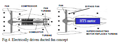

FSU all electric aircraft turbine propulsion w/ superconductors
Anybody familiar with the just released FSU electric turbo fan research by Masson and Luongo?
They believe they a design that competes on a physics basis with the the mighty icon of modern aviation, the gas turbine, though they're far off yet economically. My take is their essential contribution is to up the power density of the electric motor via a super conductor application from the usual 1kW/kg to as high as 20kW/kg. That compares to ~8kW/kg for the typical gas turbofan.
A major issue is the electric power source which would be the usual scramble for fuel cells, batteries, or even a combustion powered electric generator.
Electric 'jet' aviation would have several benefits:
-Engine itself would be over 95% efficient versus 60% typically for the turbofan
-Plenty of electric power (from whatever source) to run electric actuators instead of hydraulic
-With at least a partial hybrid battery system, recapturing some of the 16000 megajoules of Mgh energy of a large jumbo jet descending from cruising altitude becomes a consideration.
-Eventually the engines could be substantially lower weight than gas turbine comparables.
-Faster power up response.

I wouldn't call it an electric turbine, as it's not using any type of gas cycle. It's just an electric fan unit. This is a nice idea, but it's not getting off the ground until they find a power source: which is a fatal flaw.
Cyrus said:
I wouldn't call it an electric turbine, as it's not using any type of gas cycle.It's just an electric fan unit.
You're right
Yes it is problematic, though I doubt fatal. The first IEEE paper points out the possible sources: traditional gas turbine electric generators, batteries, and fuel cells. The gas turbine generator would use traditional fuels, with the advantage (as the paper details) that there are significant aircraft design advantages in decoupling the propulsion source from the main energy conversion. Batteries and fuel cells are unsatisfactory at the moment only for 100% electric designs; a hybrid power source would still present major advantages: e.g. much quieter take-offs and landings, more efficient operation, etc. Even in an all battery or an all fuel cell design, the limitation is essentially only range (though that is drastically shorter for now, maybe 30x shorter.)
I believe, as the authors suggest, that the primary shortcoming of the concept at the moment is the economics of superconducting electric motors and associated cryogenics plant. Otherwise the advantages of electric ducted fans are such that I'd expect them to be already in use in niche aviation roles.
Example all battery case
Regional jet like this Bombardier CRJ900.
http://www.aerospace-technology.com/projects/crj900/
Assumptions:
-Replace the entire max Jet-A fuel load of 11150 liters (9 tons) with batteries
-Battery energy density 0.2kWh/kg (about 55x worse than Jet-A)
-Replace 50% eff. gas turbo fan engines w/ 98% eff HTS electric fans
Gives me a maximum range of 150+ miles.

If your numbers are right, that's terrible performance.

Yes, certainly. Max range of that aircraft is normally 1720 miles. Though here's the key interest for battery power: assuming the HTS fans can be made cheaply, the battery powered aircraft is about the same cost per mile as the Jet-A powered one, including the battery cost, even at today's battery prices. Battery prices will go down, Jet-A will only go up.
An airplane that has a range of 150n.m. is an epic failure, no matter how cheap per mile it costs.
How do you measure failure? One can imagine the case that an for say, 20% lower operating costs an airline might use a similar plane to do nothing but make the shuttle run from NYC to Boston five times a day. And, it might offer be able to operate at night because of reduced noise, thus opening up time slots not available to traditional aircraft.
Realistically, I suppose that the costs of certifying a radically new technology aircraft for a small market segment make the 'electric shuttle to Boston' unaffordable.

You're taking an existing aircraft and reducing its range by an order of magnitude. That's always bad - really - really bad.
